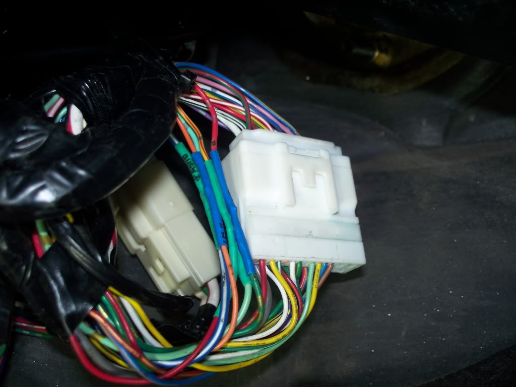

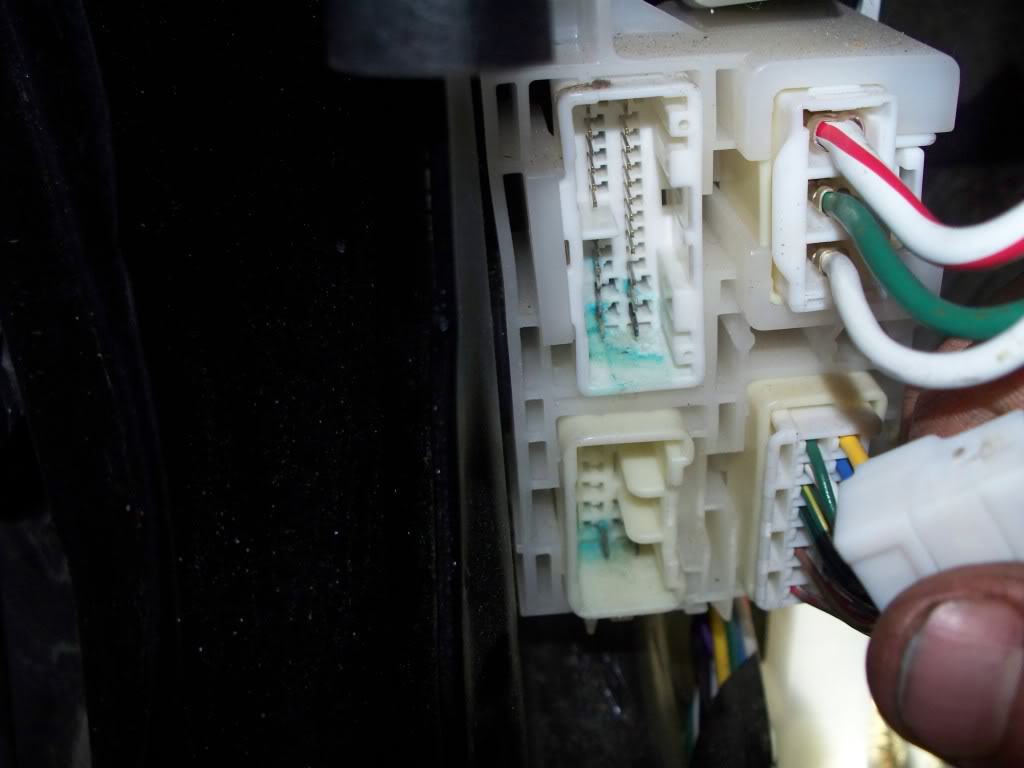

yea just check the kick panel.
my ignition would stay powered. like my dash lights were all lit as if my key was tuned to acc, when my key was in my hand.

Ah yes, this is exactly the sort of thing I was talking about. Wonder if this is an issue on the IX's too? Mines sat outside ever since I have owned it and hasn't had any issues.

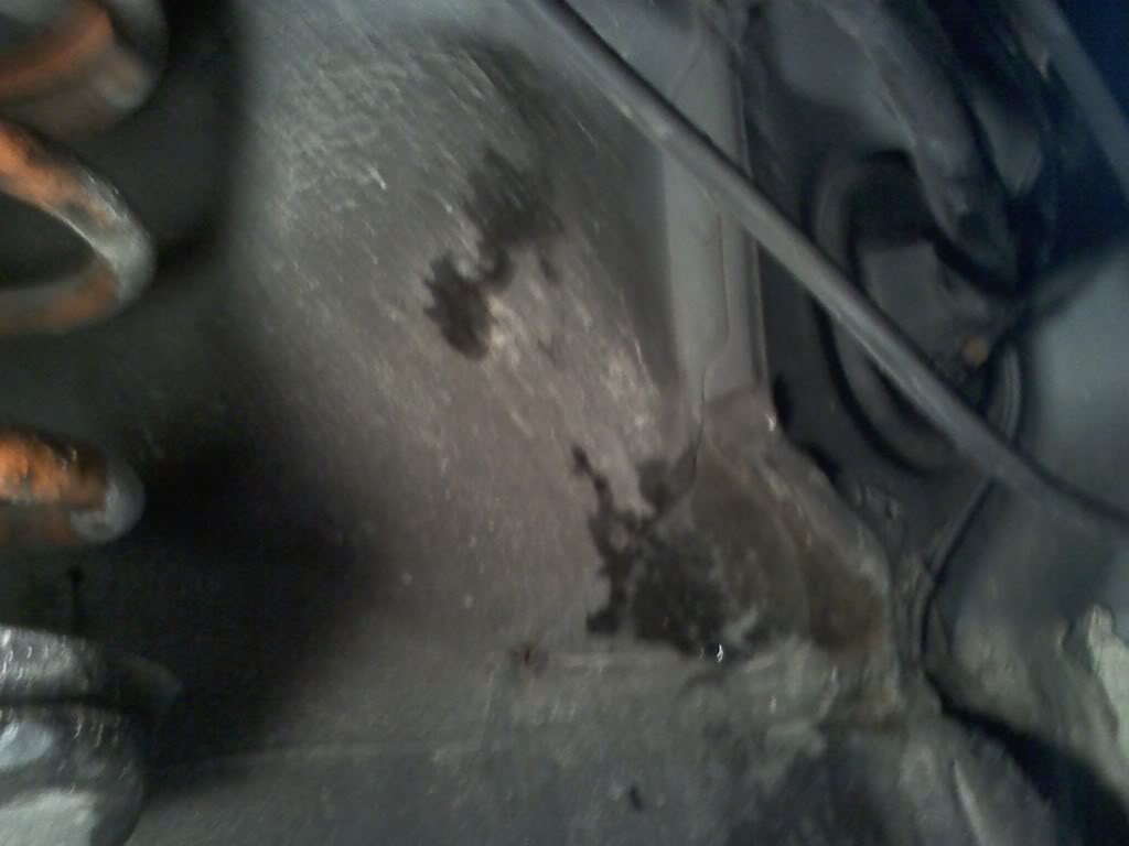

^ if you pull off your LF wheel, and the inner fender, you will see ware the hood latch and dash wiring. seal up this area the best you can. i was driving through alot of water and slush when she started acting up.
