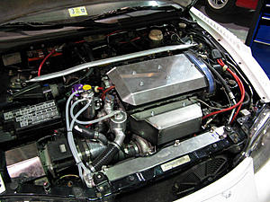

I have worked to make my Eclipse heat "resistant" as I turn it into a track car while, at least for the near term, keeping the a/c. Here are things I've done which in bumper to bumper traffic on a 90 deg sunny day for hours with a/c on have left me with peak temps pretty low (210 deg F peak):
- three 1/8" holes drilled in my oem thermostat (after reading a Formula SAE paper discussing amongst other things cooling system modifications that recommended it)
- swirl pot inline with upper radiator hose, air bleed line feeding to surge/header tank
- surge/header tank with bleed lines to the feed/inlet of the radiator and top of the surge tank, and return line near the outlet of the radiator.
- custom dual-pass radiator from Ron Davis radiators. Thicker than all aftermarket radiators, with ports for the surge tank bleed lines, water temp probe, and an integrated oil cooler.
- pull 12" spal fan and push 10" spal fan. Don't remember the cfm but at the time they were they highest I could get with these dimensions and thin enough to fit.
- fmic/radiator ducting that is sealed with aluminum tape as much as possible. Radiator is sealed to the radiator support with pipe insulation foam from home depot racing.
- turbo is wrapped with a ptp turbo blanket.
- manifold is heat shielded with a stainless steel heat shield.
- o2 sensor housing is header wrapped.
- hood has huge vents for exhausting heat and of course lowering pressure behind the radiator thus improving its airflow.
Here are pics of the engine bay, though I don't think it says more than what I've explained above. Also a shot of the car (work in progress, off to body shop tomorrow for the rest of the body work) to show the kind of hood vents I have.
Attached Thumbnails Slim Fan options? Keeping it cool with A/C.-engine_june_2011.jpg   Slim Fan options? Keeping it cool with A/C.-car.jpg

tsi awesome setup you are one of the first people ive seen build your setup around your cooling system most people do it backwards and wonder when they have problems to the op the only thing i can add that has not been said is try water wetter or another brand they do work.
