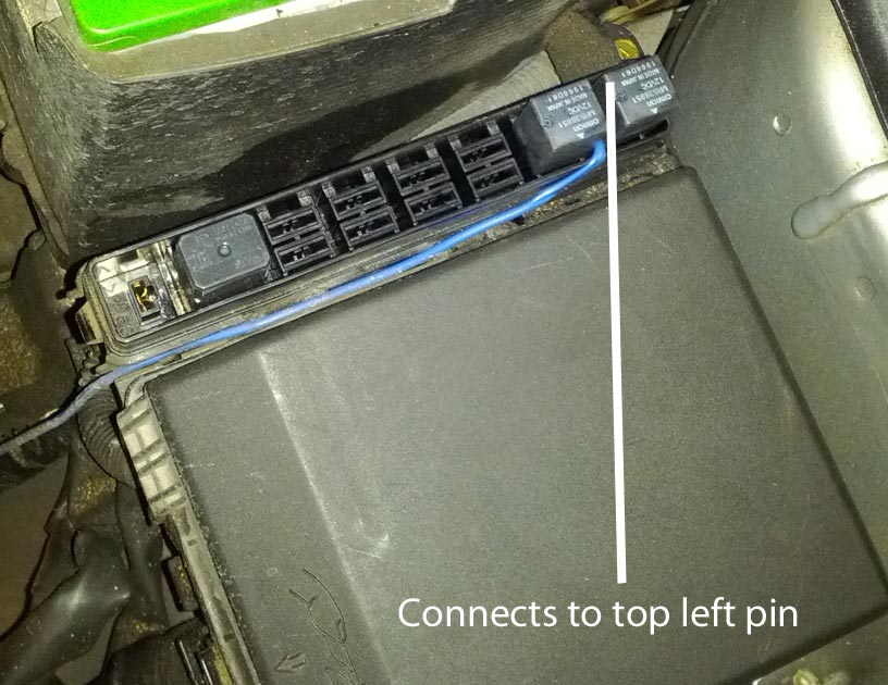

Mine are wired to turn on when the key is at "on", whether the engine is running or not. If that's acceptable for you, I can get you a pic of where it's wired.

Old Jan 26, 2012 | 05:47 PM
Raptord's Avatar
Joined: Mar 2009
Posts: 3,525
Likes: 20
Originally Posted by overdrive1
this is how I had it setup previously but please send me a picture anyway, if your setup is better than mine, Ill do that.
Here are a couple pics. Previous owner is the one who did the wiring so I can't really tell you how much work it was or what exactly needed to be done.
The blue wire is the one coming from the fog lights.

Fuse 13 is the DRL fuse.
Yeah I know there is one fuse under the hood thats hot only when the engine is running. I was able to locate one in my Montero, so I was hoping someone knew of one in the evo.
on the right side of your fuse box is a set of 8 fuses. The top right one is a yellow 10 amp., tap into that one.
