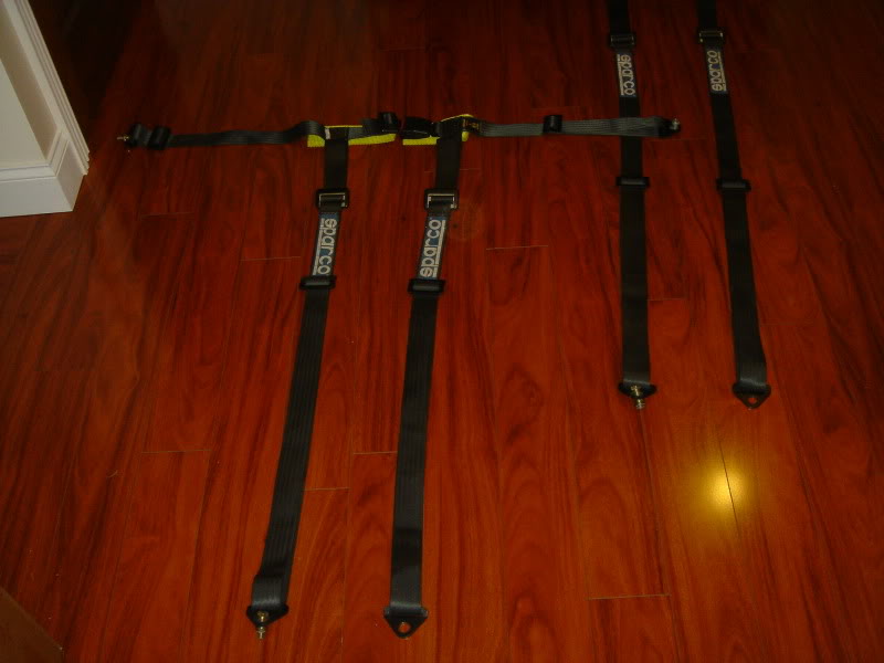

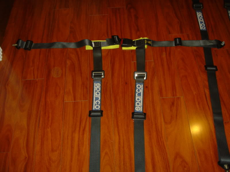

I am hoping to pick up the sparco harness in the attached pic and wondering if anyone knows if it will bolt onto the stock locations of an evo 9...

Stock locations? what do you mean like just replace your existing seatbelt? If so the answer is no. You will need the bolts on the bottom of the seat and a harness bar across the back to have the tops mounted to.

Wouldnt the rear locations bolt onto the rear seatbelt receptacles ? and to install the 2 sides, I would have to take the factory seatbelt off ?

they are just 4pt harnesses correct? I have the bolts and still retain factory seatbelts(previous owner installed)
about the rear part I'm not sure
http://www.lancershop.com/customer/p...cat=212&page=1
Thats the bolt in question. they have longer versions as well... sorry I cant be of more help.

ive even them ran to the back seats... there is a plastic cap on the top of the back seats... pop that off and the harness would attach there.... just looks kinda ugly
i would get a harness bar

i had these exact ones and yes. they work in all the stock location. and the back seat.
