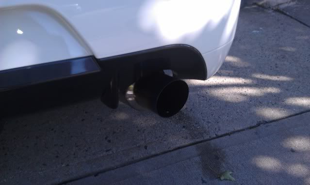

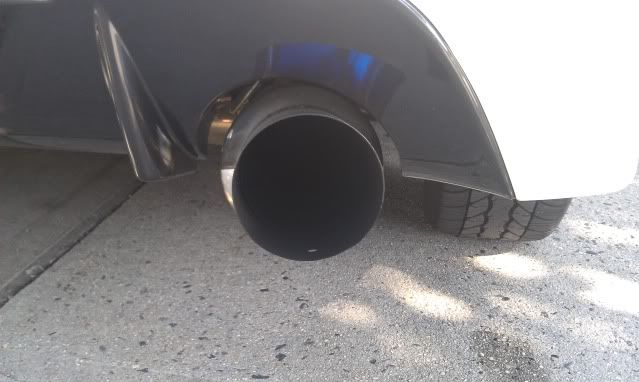

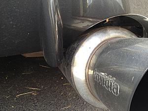

My evo 9 got IDM bumper and diffuser w/ Invidia N1 exhaust. I dont know if this problem is common for this combo or what, but the exhaust tip's location is a little bit off to the left and my diffuser just got squeezed up badly by it. Totally deformed. The N1 exhaust is installed by the car's previous owner who seems to not care about this look but I just cant take it. Had somebody try to pull the exhaust pipe to the right, but it will hit the fuel tank. So could anyone tell me if this is a common problem for the Invidia N1 w/ JDM rear bumper or it is caused by installation error? THANKS....

pic posted. Thx.

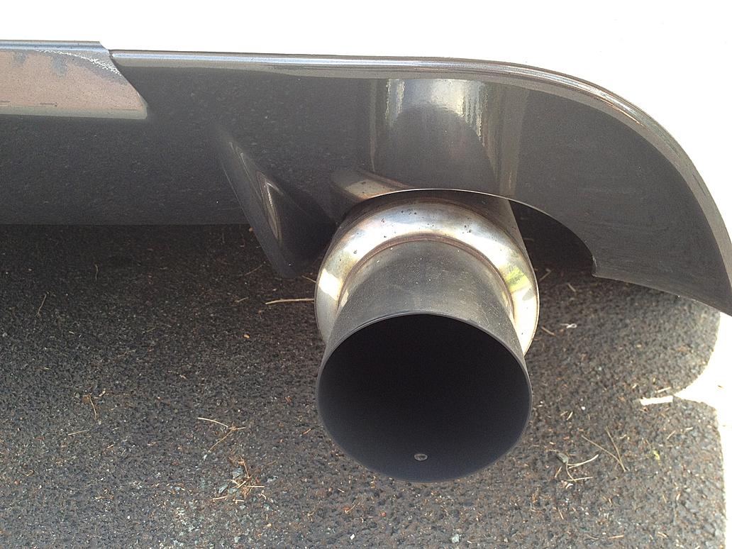

same exact bumper I have and exhaust and ran into this prob last month, when to the exhaust shop they trimed a inch off the pipe and rewelded the exhaust now it fits perfect, ill post a pic cost me $50 bucks
Also it getting squeezed bc the exhaust is pulling the diffuser back

mine looked exactly like yours heres after I got it modified
