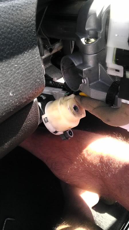

I had this problem intermittently for a while and it progressively got worse and worse.
Same exact situation as yours and here's what was wrong with mine
The plastic part here you see had been cracked in the small opening there and worn and somehow wasn't turning far enough to connect the circuits to start. Easy to check, so check this part.

Where is the plastic part located? And did you replace it?

That plastic is the actual ignition switch... it's what theives pry off to start the car with a screwdriver... Where you place your key is the lock cylinder... follow the lock cylinder to the other end and you will find the ignition switch.
But first... What happens when you turn the key?
