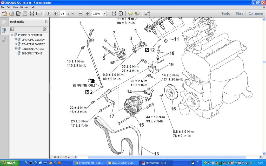

what did you guys with evo 8's do with the top bracket for the alternator. it obviously wont line up without doing any modifications did you just leave it or fab it some how. it does bolt behind the water pump pulley as well. but i feel like it could still move. http://i198.photobucket.com/albums/a...ortbracket.jpg
