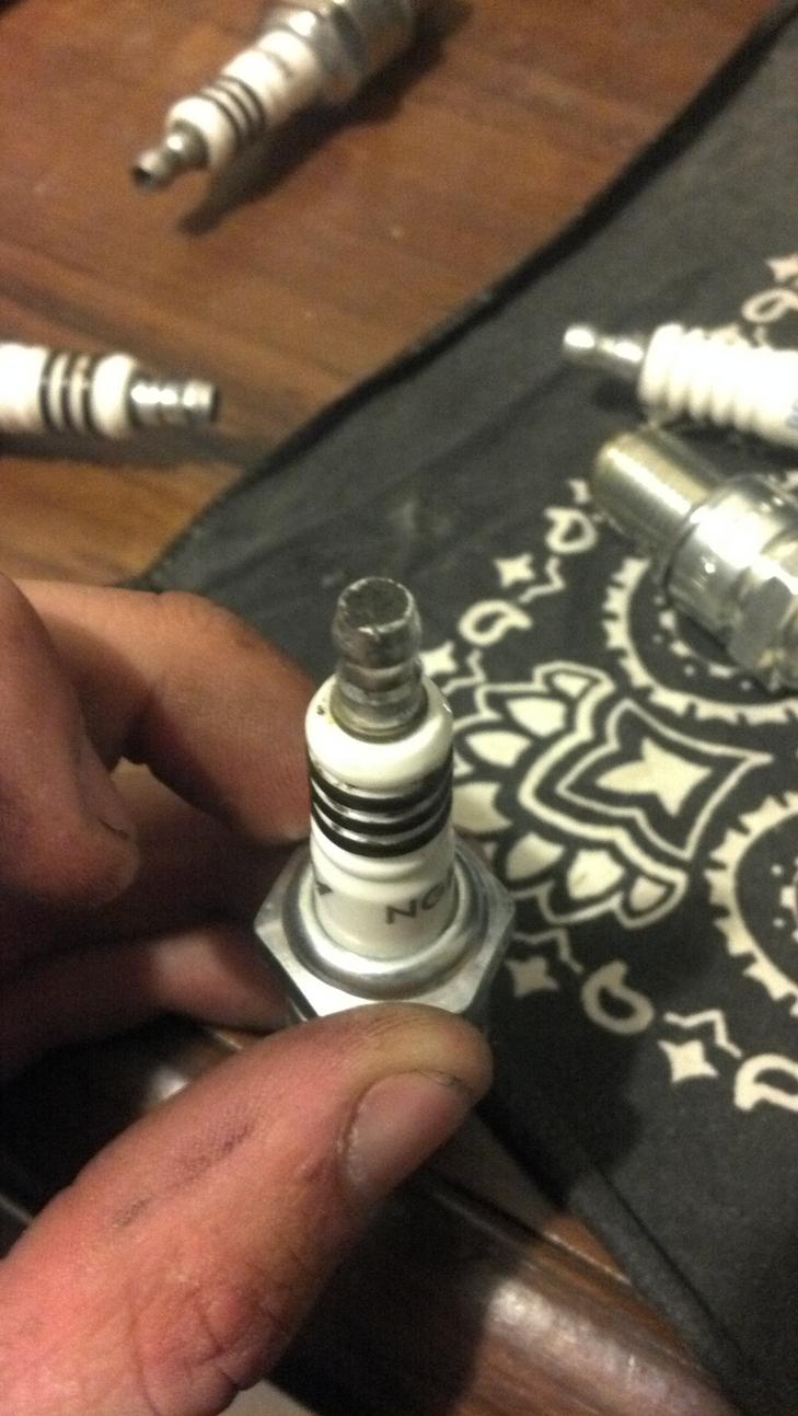

Question. Whats all this gunk crap filling the top of my sparkplugs from my spoolinup cop? Is it meant to be in there??

I have had mine for over 2 yrs without any problems or whatever gunk you are talking about. How about some pics. Maybe you have oil leaking into the spark plug wells

Di-electric grease?

Yes its at the top of the sparkplugs noway oil is getting up there it looks like grease im confused lol

ok im taking pics. my car has been running like ****! i wonder if this has anything to do with it. i looked down the cop and its all over inside the coils.

Dielectric grease? Did you install it yourself?

heres the "gunk" its filled 8 sparkplugs the cop is fairly new

Update i talked to matt and he put dielecteic grease in them

die electric grease is perfectly normal. Basically it keeps the spark coming out the coil on plug from shorting out in the spark plug hole. If your car doesnt have it on there, its fine too, i do it for piece of mind, overtime your coil boots crack and deteriorate, this helps with that too keepin a solid barrier in there. Are you having a problem with driveability? cel?
