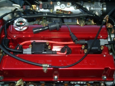

Maybe the wires are on wrong, it has happened to other members before.
Should be like pictured.
Good luck

From: chicago,il
^^ use picture above.you see grey connector?chek these on both coil packs.

Thank you guys for the feedback! it is really greatly appreciated!
As for the car, I got it running good now. First issue was my fault, I had it wired wrong until I saw the pic (thanks btw). Next issue was, I was sold the WRONG plugs!! Once I got it set-up right, the car still ran pretty bad. Compared plugs and they are deff. different than the ones that came out...ahhh.
