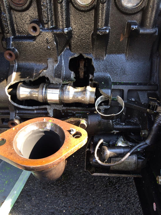

I was driving normally and boom
It was a fresh Oem build. I was in the middle of breaking it in. 750miles on the motor tops

Too much NOS.

I'm gonna guess Balance shaft failure. Did you replace the belt, bearings, etc with the oem rebuild?

holy cowwwwwwwwwwwwwwwwwwwwwwww man time to go 2.4 sorry for your loss brother. Did you build the motor yourself?

Several things could be the factor. Tune, improper build, no oil, etc.

Someone incompetently timed your engine / balenceshaft.

If that was the balance shaft, and the bearings were replaced, was it 100% verified the oiling hole was lined up?

It was a fresh build no used parts was used on this I didn't not build it myself someone else did

Who built it. I don't think that happens randomly with no rhyme or reason.

Who built this. Look like low oil pressure

You cant go back to your guy? It was his work

I agree with the above comments...talk to the engine builder. I doubt that will be a quick resolution for you, though, which makes it bad for you since this was your only vehicle.
