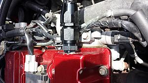

Attached are the pictures of my setup. There is no air recirculation, both lines are capped off. From what I've been told and researched, it looks as though it's more of a tuning issue. I am still running the stock maf.

Is the sound replicatable everytime you get near full boost?
I'd try new plugs. And tighten the gap down a bit, try .022-.024.

It's every time I use 3/4 throttle or above. Every time so far.
