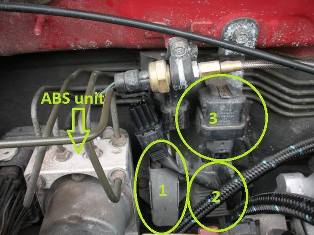

Hi all, Sorry if this was already explained somewhere or if this is the wrong section to post but i couldnt use the search bar because i really do not know what these are. So, I'm in the middle of a wire tuck and wondering what these three boxes are that were mounted on the firewall by the ABS unit (which i already deleted). I know one is a resistor box for the injectors but not 100% which one so if someone could just tell me what each is and if they are important. Thanks!
**also i no longer have ABS would it be safe to remove the harness running to hub at each wheel? mines look like they were rubbing on the tires and the wire are exposed now, would be nice just to remove it completely**
1.
2.
3.

First is the resistor pack and you do need that, the middle item I'm not sure of and then as far as the relay goes where was it at?

the relay is either the acd pump or the fuel pump. From the factory the ACD pump relay, Fuel Pump relay and injector resistor pack live on a plate mounted to the firewall towards passenger side.
One of the metal ones is the fuel pump resistor for high/low voltage to the pump, also mounted to the same plate.

All three were mounted on a plate next to the ABS unit. And its a 2003 Evo 8 (gsr) no ACD
