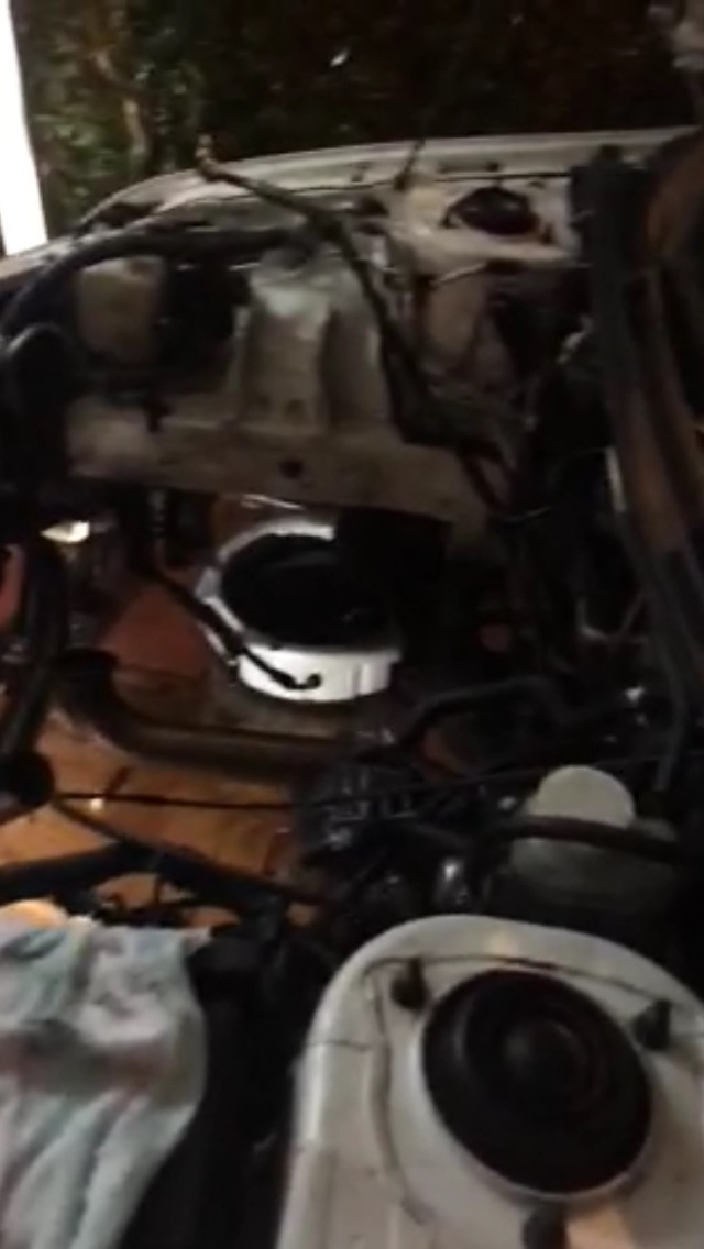

Not big deal engine us out the car and standing in an engine stand2nd lifted head in a month? Bad thread???-image.jpg.
