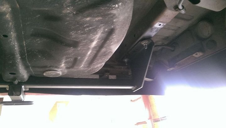

Just had a hitch mount fabbed for my evo9 to cart around bikes and track day tires and not have to deal with a roof rack. Good buddy designed + built it [race mechanic and fabricator]. It's based on a 1+1/4 Curt receiver that he welds a cross bar and 'ears' to catch the bumper bolts and an L bracket on the opposite end of the receiver to bolt to the diff/subframe mount. All steel, painted or powdercoated depending on quantity. Very strong, can jack / tow the car easily and NO CUTTING / MODIFICATIONS to the car required. Straight bolt on - remove bumper cover and bumper, and this bolts right on.

Works awesome, virtually invisible on the car. It does locate the receiver below the stock bumper so keep that in mind. With my bike rack i've only scraped it once on a very steep driveway departure.

final design prior to finish welding and paint.
with my 1-up rack on it.
speed tested to well over legal =) and a 9 hr road trip.

I like the look but would like see a few more pics of the hitch w/out the bike rack installed
Also, Can you take a pic of the square tube that extends towards the rear diff. What does that attach to?

The hitch is installed on my car, i can take a couple more pics but the one i included is pretty much it. What do you want to see more of that you can't see in the one i attached? There's not really any detail you're missing..
The rear bracket bolts to the rear diff / subframe mount. Pretty sure it's the 2 rearmost bolts on #5 in this diagram.. if you look under the rear of your car you can't miss them.
