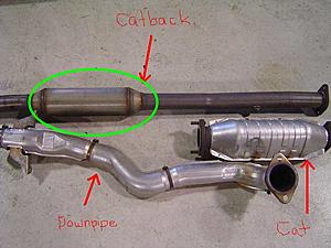

ok i will do my best to explain it to you even though it is kinda hard with out pics.
your exhaust system is comprised out of 3 parts: the catback, the cat itself and the downpipe. the catback is the part of the exhuast that starts after the cat and goes all the way to the end (this is the part with the muffler). before the catback you have the cat which can be replaced either with a high flow unit or with a test pipe which is basically an extension pipe. before the cat you have the downpipe. the downpipe is just a pipe that allows the gases to exit. idealy you will want to replace the entire system (all 3 parts) to allow a more free flowing system with fewer bends. you can change only the catback but you will get better results by replacing all 3 parts. also, you would want to do your best a match the diameter of the system. a full 3" catback will only flow as much as 2.5" if that is the size of your downpipe/cat.
i hope this clear it up a bit but i will also try to get you a pic.

these are NOT my pics. i found them on here. the system is the HKS DP, PERRIN CAT DELETE PIPE AND HKS CARBON-TI CATBACK.

If you want a quiet exhaust, then search for aftermarket exhaust systems with resonators (circled green on stock catback). I believe HKS, RMR (has 2 of them), Fujitama (sp?), JIC, and some others you may have to search.
