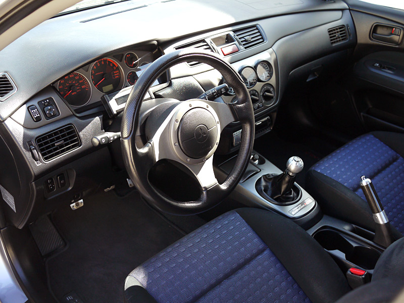

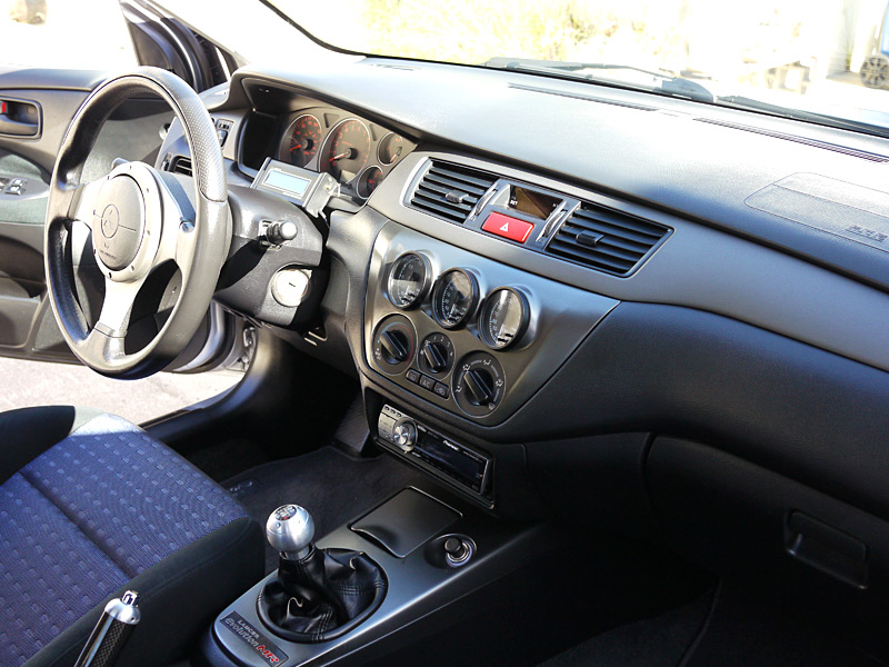

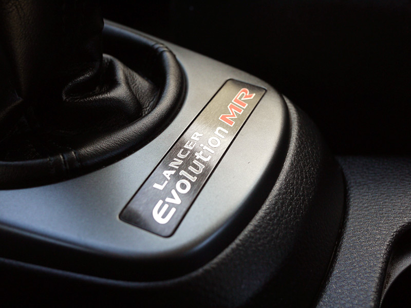

I was one of the first to do the 5spd swap WAYYYYYYY back in 2007 and I reused my 6spd console, 6spd boot and 6spd shift knob. If I remember correctly I had to dremel away one very small part under the opening that you couldn't see once installed.
Either way. It worked for me.

Looks good Razorlab!
One can certainly get away with it with modifications and reuse the parts.. Some prefer the look of the MR interior shifter console (like you and I), others prefer the 5 speed console with the grey ring surround like on the steering wheel. I wish that that they kept them the same
