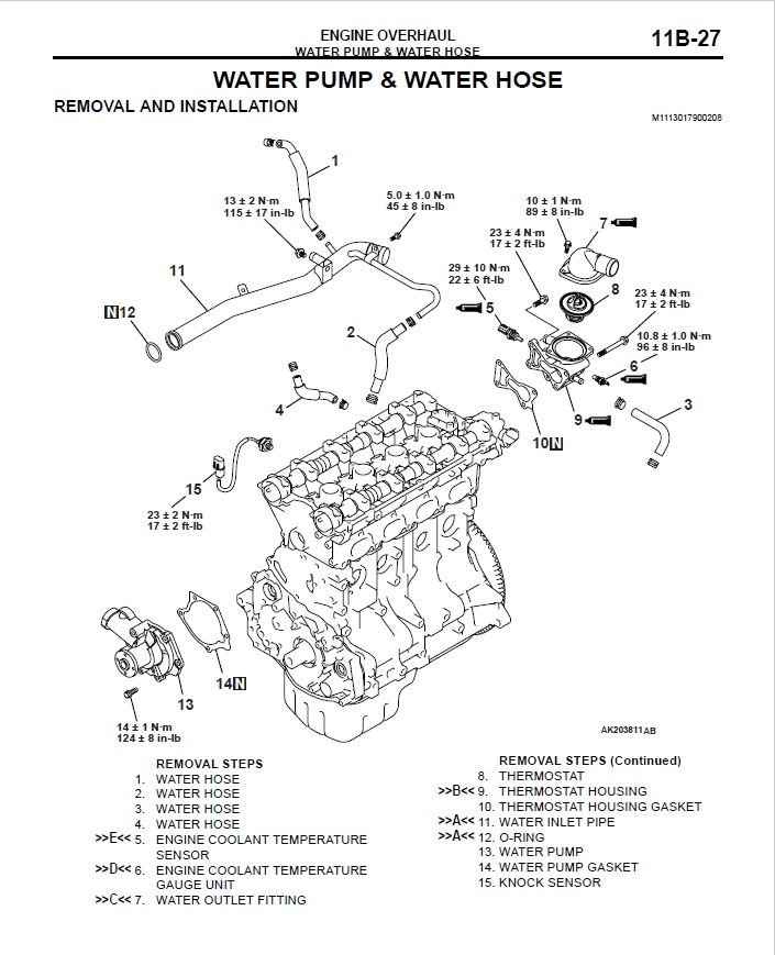

I daily drive this car so I'd like to get this figured out asap so I know when the car is actually overheating. I guess I will remove my catch can and strut bar to gain access to the alternator to check connections. I did spill a bit of oil on it when I replaced the mivec line and filter but that was months ago. I'm curious if I may have damaged something when I accidentally touched the Uicp to the battery and I think the other end hit the radiator or radiator support or somewhere in that area and a few sparks went off. This was like 2 weeks ago. Where is the temp sensor for the cluster heat gauge located? Other suggestions?

this should help:
Old Dec 20, 2015 | 07:55 PM
Biggiesacks's Avatar
Posts: 5,690
Likes: 708
From: West Coast
