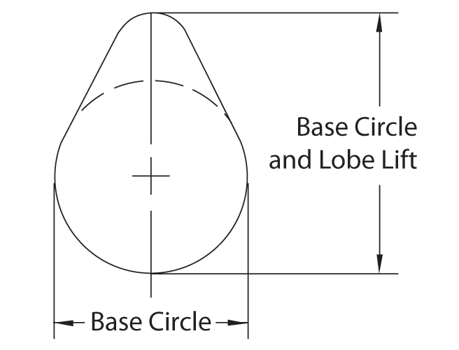

get some calipers and measure from the 'peak' of the cam lobe to the base, then measure across the width of the lobe. now subtract the first from the last. that will give you a pretty close approximation of your lobe lift. the published specs from the manufacturer should give an indication which cams they are.
Old Feb 15, 2016 | 12:54 PM
TrendSetter's Avatar
Joined: Jan 2007
Posts: 303
Likes: 26
From: florduh
here are the two dimensions im referencing
