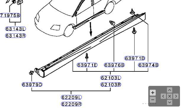

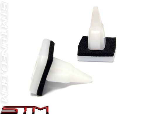

Can anyone tell me what size the screws are for these clips? My sideskirts weren't utilizing these clips before and were not held on very well. Want to do it right now but don't know the screw size. Any help is greatly appreciated.
Old Jun 4, 2016 | 09:11 AM
Part no. 63971D = 4x16 tapping
Part no. 63971E = 5x16 "

Thanks man
