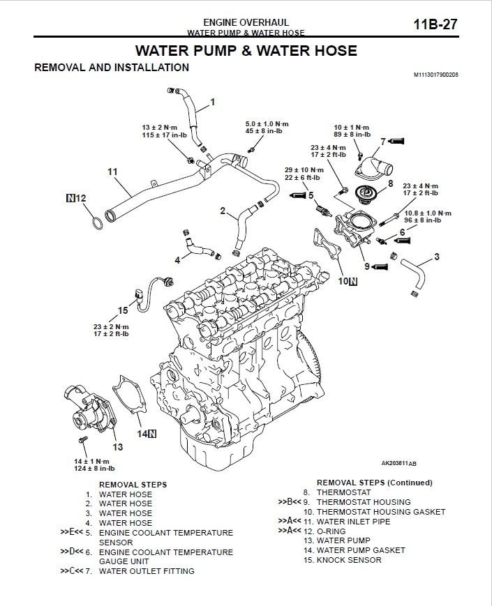

This is from an evo 8, but it might be the same, you can see #6 is the sensor you would want to look at.

Awesome stuff, thanks guys. There is the sensor on your diagram, number 6, it's the dash temp sender with a single wire going onto it with a spade terminal. If i unplug the wire from the sender the temp gauge in the car dies... The moment i plug it back on the gauge shoots up again. I have got a new sensor ordered and il go check the grounds now as barney said
