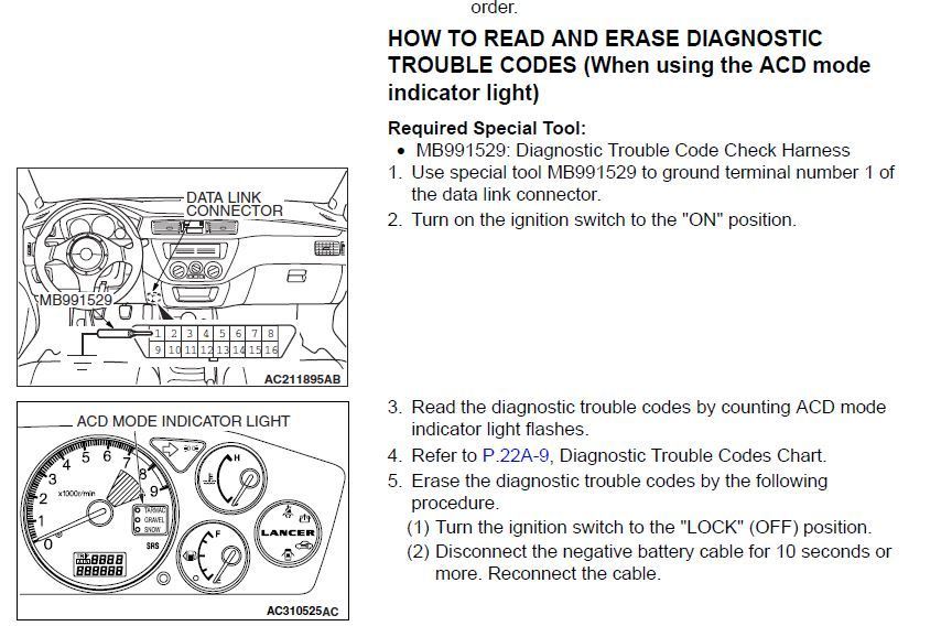

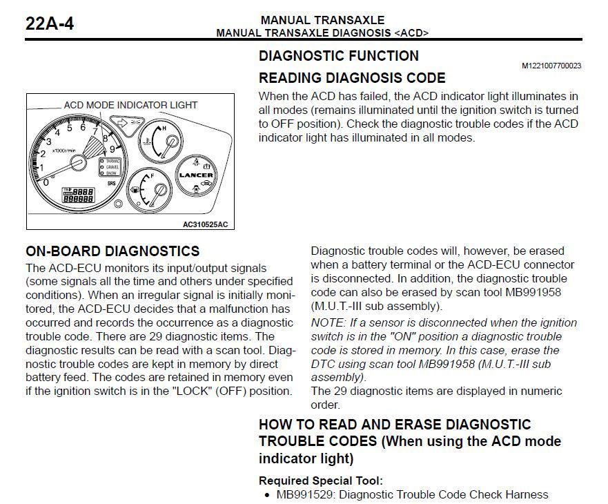

In order to pull that code I need to actually get behind the glove box and and access that ecu right? I saw a few diy on that but i only have a 1.3 universal flash cable from evoscan not the tactrix.
Old Oct 14, 2016 | 08:30 AM

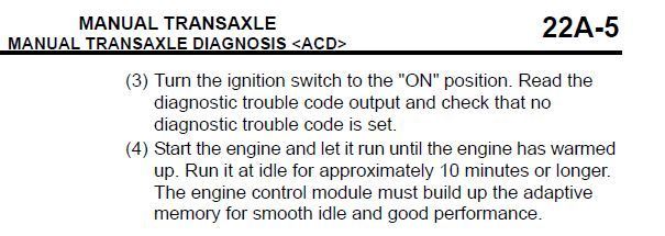

Here are the manual notes:
