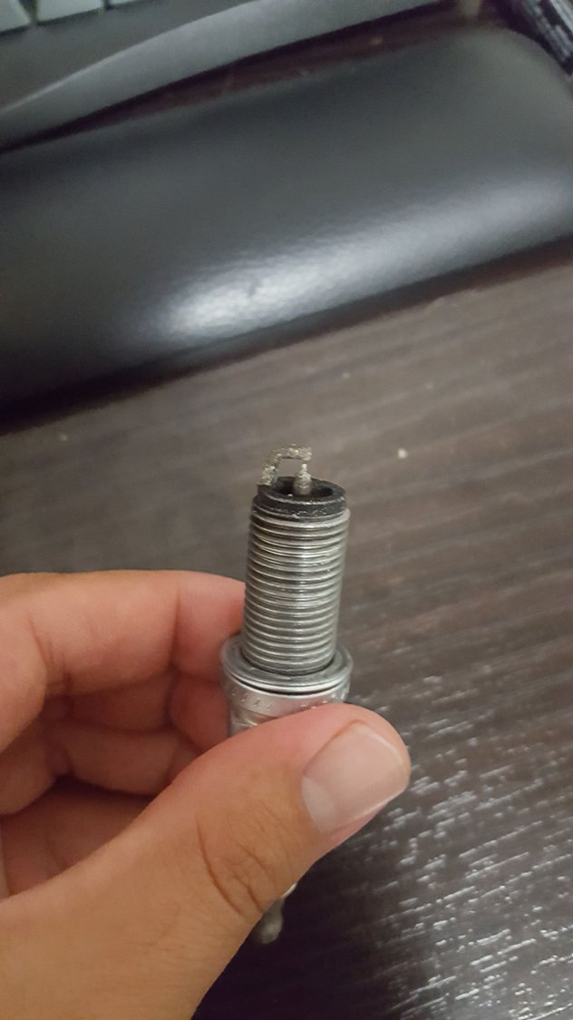

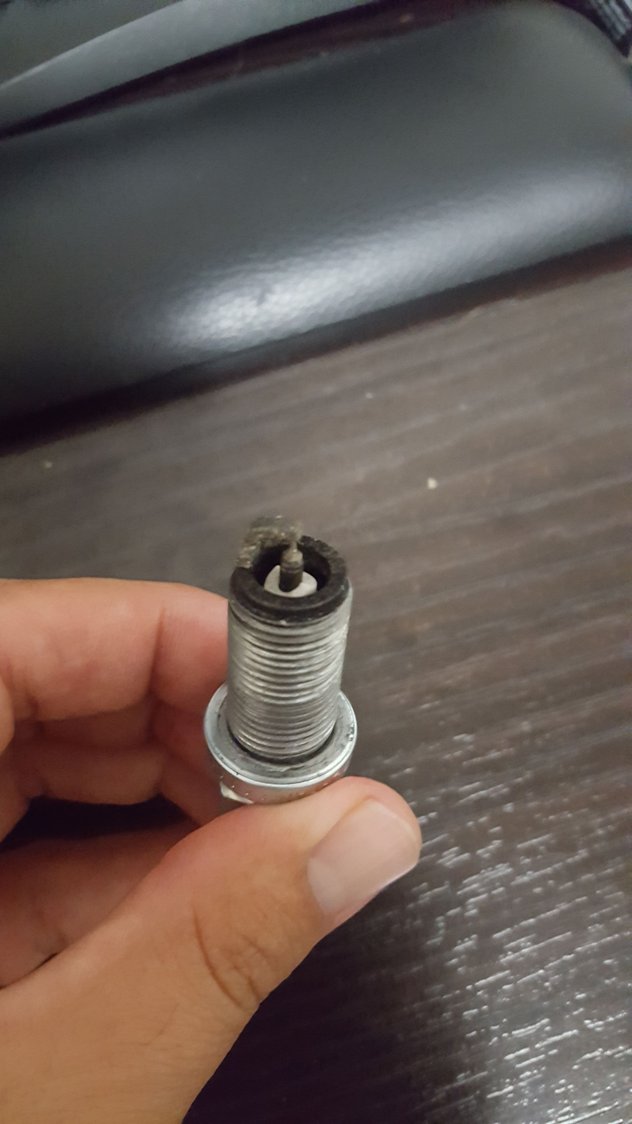

Recently had the porcelain get destroyed during a WOT pull. these were brand new too. Where do the majority of you purchase spark plugs? I order everything online but spark plugs I try to get them in store fearing that they would be mishandled at one point during shipment. Well that didn't seem to matter since the ones I got were from the store. O'Reillys surprisingly stocks the NGK plugs we can use in our Evo 9. Anyone with a similar experience purchasing plugs from stores like O'Reillys? I'm going to now purchase the Mitsubishi packaged NGK plugs and I will get those from the dealership. This was unfortunately the 2nd time that it has happened to me, first time my valve was not so lucky. This time around I may have been lucky. Car fires up and drives fine. The idle is slightly off from before but I have yet to throw in the brand new plugs. I hope people can chime in, I don't know why this has happened to me twice if it's something I'm doing wrong then I need to correct it. Car has a built motor running lots of boost on e85 so I'm not talking about this happening on stock turbo on 91.

Razor lab, sorry to see what happened to your evo, I already went through a motor, I don't want to experience that again.
I'm definitely concerned about this and want to get to the bottom of it. The first time it happened, it may have been fueling issues since my injectors were maxed out at the time. Stupid move on my part. Fast forward, redid the head, installed ID2000s. Ran the car with no issues, probably more boost than before on the new tune and on e85 for I'd say more than a year. As part of my frequent maintenance, I swapped my plugs with new ones (this time around) less than 200 miles and only a handful of pulls and this happened. My AFR was not lean, no sign of knock during the pulls. I just got a tactrix and happened to log during my pulls but not sure if it will tell me what I need to know. Car was still running, just a small weird misfire during idle. Drives decent but I can tell there's still something wrong with my car. Here are some pics of what blew
I have yet to do a compression and leak down and I'm also going to swap all 4 new plugs

Broken porcelain on the business end and speckle pattern is detonation.
