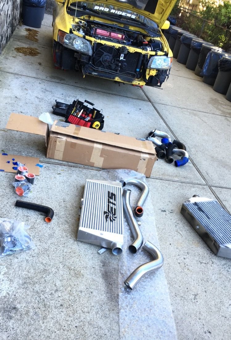

Whats going on fellas. Got 2 questions for you guys today. I bought my intercooler brand new from a local guy who used to own a ct9a. After about 4 months of laying around I decided to install it. I got everything off and went to mount the intercooler and realized I had some fitment issues. I did some research and found out that ets included a spacer for the intercooler. I never received these from the seller and was wondering if anyone knows the exact size of the spacer so I could possibly fabricate something myself. (Access to a welder) Or do you guys think if I contacted ets and filled them in on my situation they'd help me out. I don't mind paying for just the brackets.
My my second question is right now I have a turbo xs recirculating BOV. If I have the stock flange on the upper intercooler pipe I should be fine if I just reconnected the recirc. hose right? No need for a retune. Sorry maybe a noob question lol.
Thanks for for any and all help gentleman

The top bracket, hardware and spacers is typically in that bag with the clamps. If for some reason it got separated the spacers are 5/8" thick. One on each side between the car and the intercooler.
