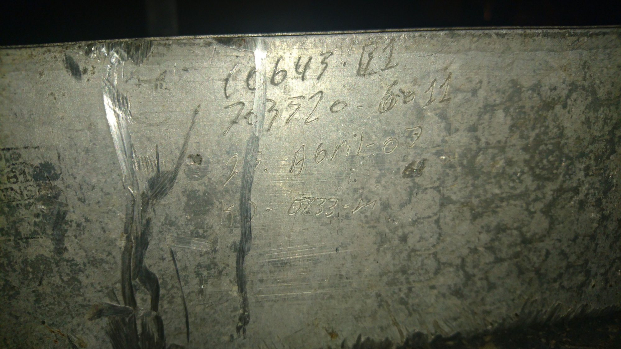

Hey everyone..
i bought this 3.5 inch intercooler off of someone on these forums, and he said it was a Buschur racing intercooler. Literally nothing fits and this is such a pain in the *** to install and havent even finished it because nothing really fit. Was he lying or just BRs design is off.. Please help and thanks!

Looks like a Buschur Street core you'll need their LICP that comes with the kit or have one fabbed somewhere that IC set up wont work with a factory location LICP on the passenger side as the inlet to the IC comes out the back of the end tank as you can see.
