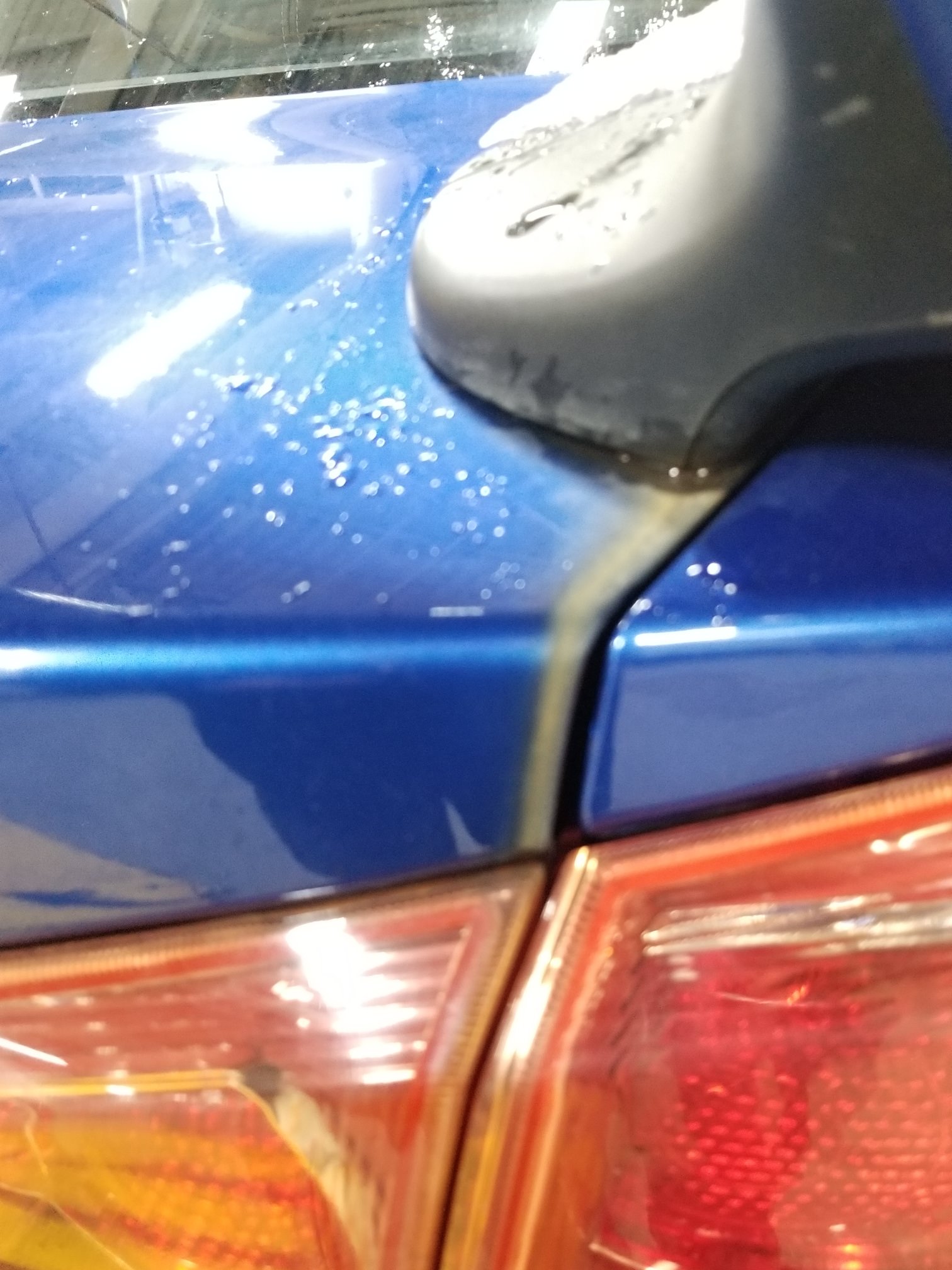

I guess my post made it seem like I was giving up on the car. I wont be giving up on the car, even if it does not make financial sense (within some reason of course). I was simply stating the odds are very much against me on a car that is probably terrible compared to others in terms of where the rust is. I will be saving up to either buy a rear clip or the side rails needed to make her perfect again. I have too much sentimental value on this car to let her rot in a junk yard. Plus it being an MR trim justifies me keeping it too.
As long as I can have the car last me a year or two I can do a proper restoration on it.

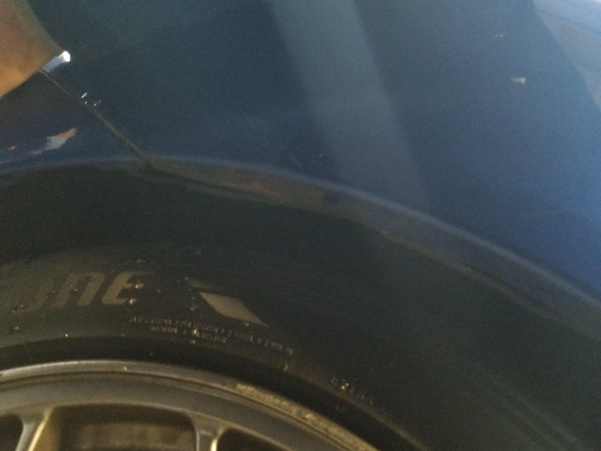

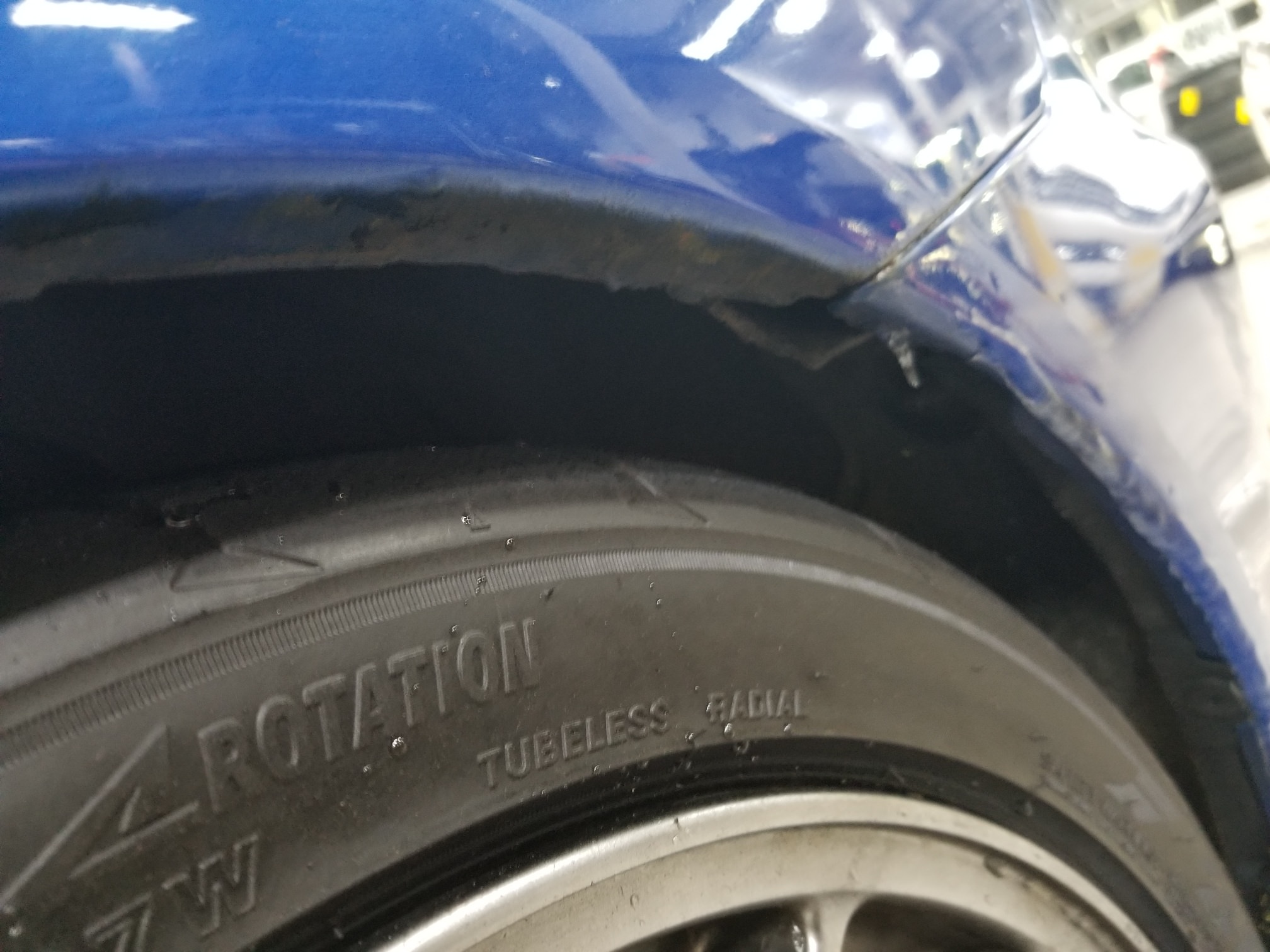

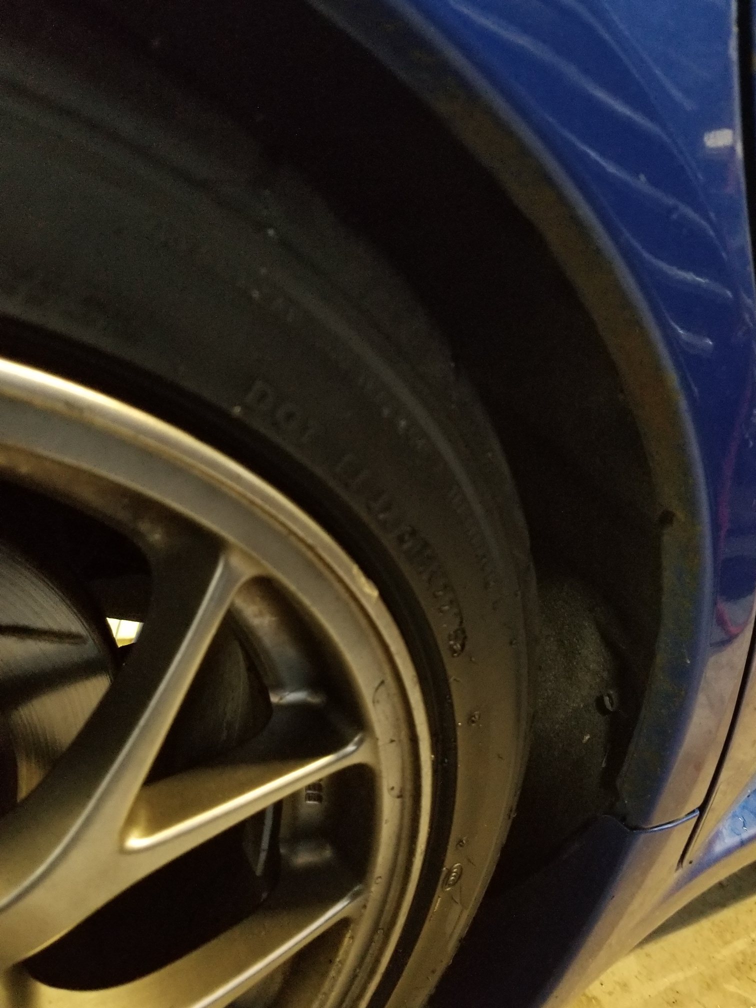

My 03 is similar, but I have holes in mine
I've had the car for a few years now, the body is in absolutely flawless condition, not a spec of rust in any door jams, under hood, quarter panels, under wing, NOTHING. The car gets so much attention with "how clean it is" You'd never guess that underneath the car its rotted away. I took the car into Mitsu for the recall and everyone crowded around it and the service writer chuckled at me and said "you must just want the free car wash and frame spray." Not to my surprise, he came out 20 minutes later and said a front sub frame has been ordered and he would have never guessed how bad the rust was underneath the car. So that was a free step to restoration haha. But as far as the rear goes, I am just going to send it and hope for the best. I moved from WI to CA with the car and it now sits in the garage and there is virtually no humidity/rain here so hopefully this hole doesn't get any bigger.

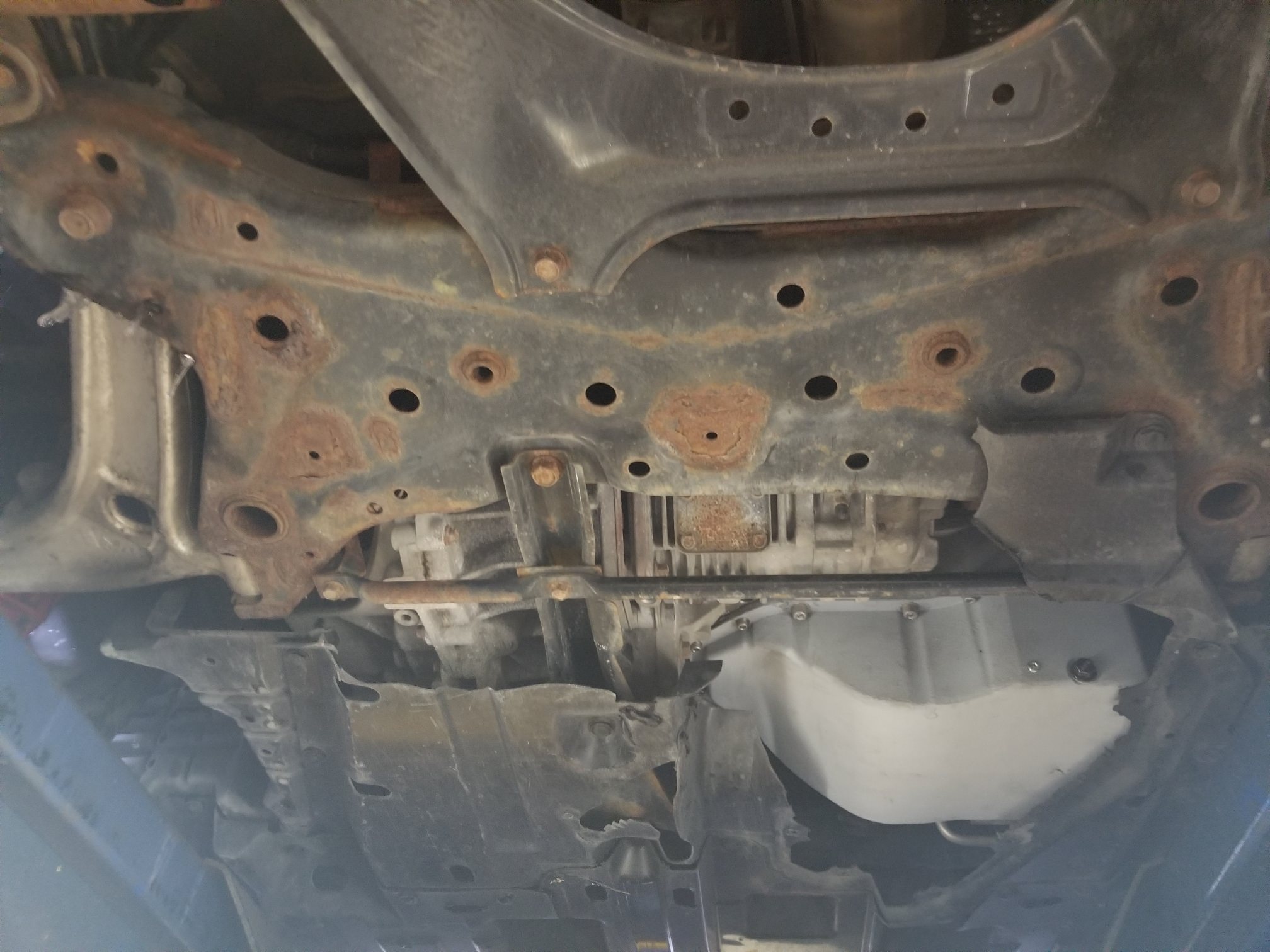

Mitsubishi won't do a damn thing to help, and the government won't step in for rust on 10+ year old cars. Cars rust, this is a fact of life, not a manufacturer defect.
FlashEvolution, that hole should be addressed. It could be cut and patched rather easily, instead of letting the rust spread.

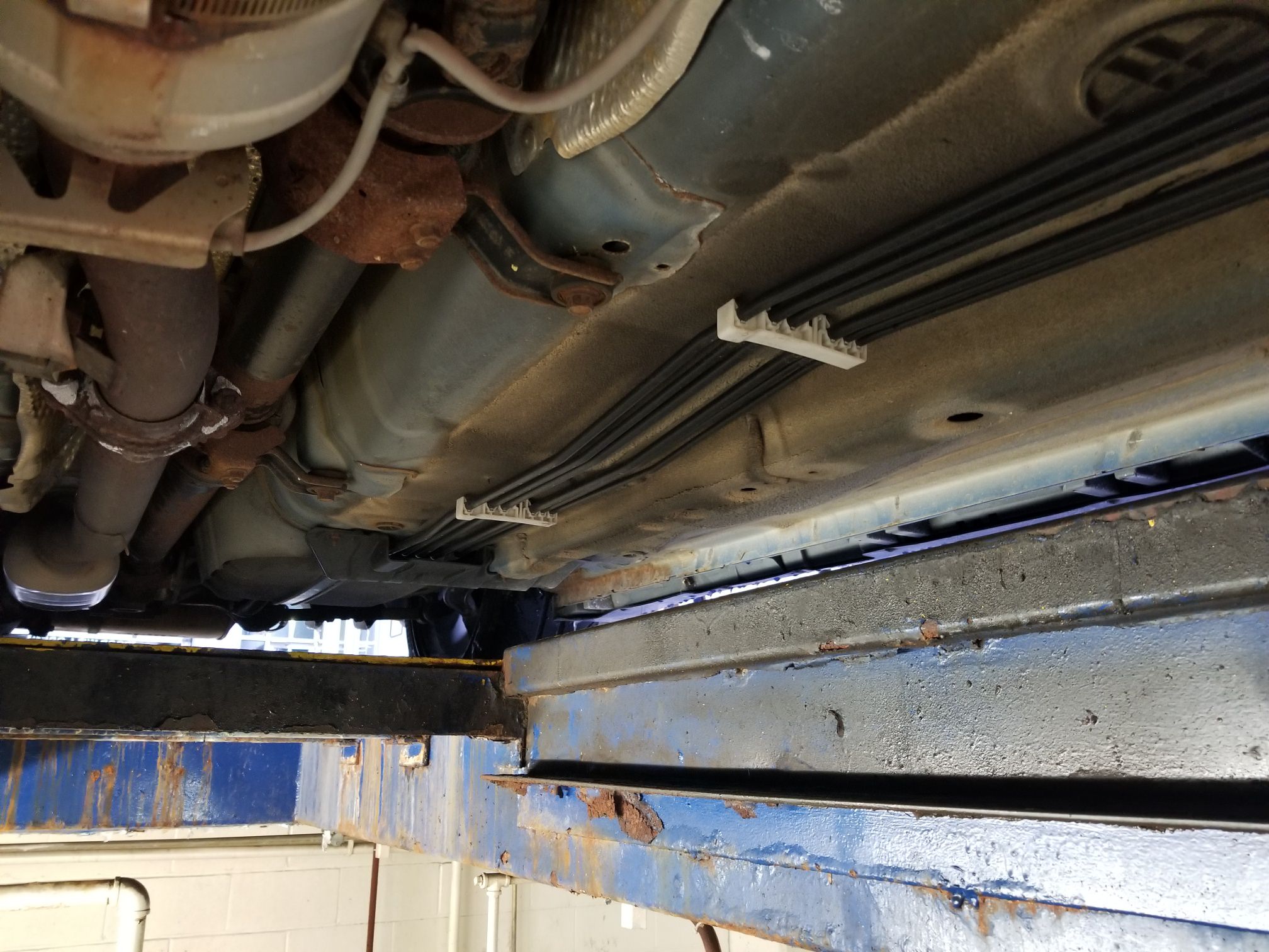

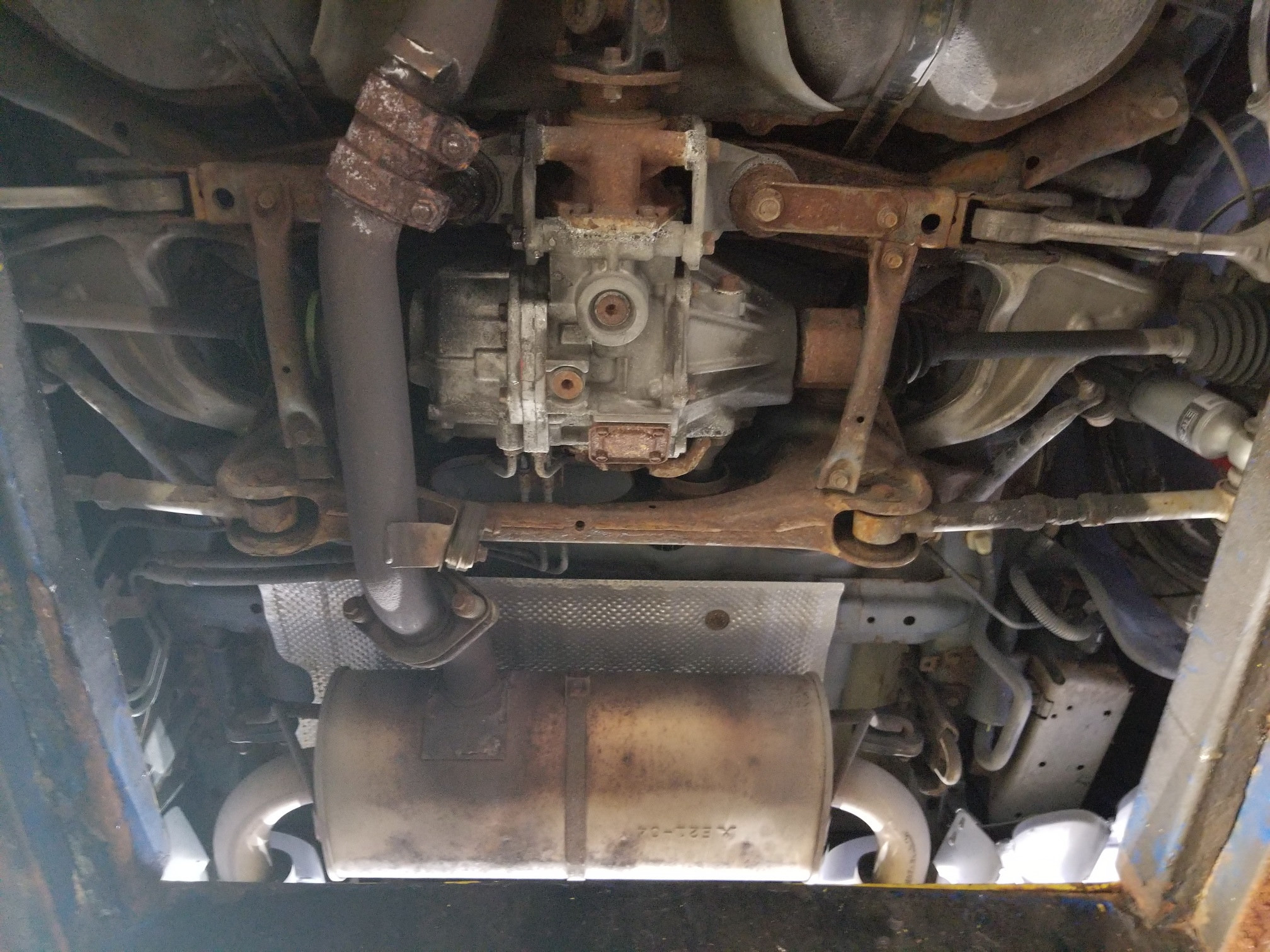

FYI, here's the 80k mile 2008 Evo-X I was talking about before. Note the rust on the inner rocker in front of the driver's side rear wheel, that is integral metal. This car is a lot worse than it looks in pictures, and is probably too far gone. Most of the cars in this thread can be saved, but you have to protect your investment. Stop rust before it starts, and fix it once it appears.

That X ain't that bad. We've all seen worse. That Krown place looks great. PERFECT for a new vehicle. Can't get their pricing tab to work, but it seems as a temporary preventative maintenance and not more permanent.

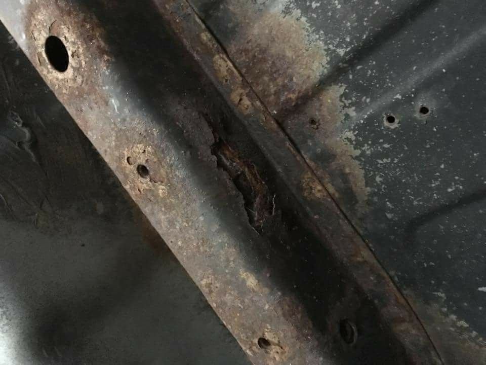

Can I ask for the update on your situation? I am in the same exact position - my evo ix mr is bone stock and looks pristine on outside. But this summer I decided to do underbody rust treatment ...but I was too late, the rust left a hole in the left rear frame rail that's not too big but on the passanger rear side it rusted through near the subframe mount point, the actual inner structure where bolt goes looks solid but outer frame is gone - so it is now a safety concern. Were you able to source frame rails / sidemembers? Does anyone know the part numbers and a place where I can buy them with shipping to US?

given the recall, i would take it to the dealer and see if they will do anything or tell you to pound sand. Start there. i do believe you can purchase the rear underbody/unibody parts but obviously must know a body or restoration shop.

The easiest way to get rear chassis legs would be to find a shop that specializes in buying crashed Evos and parting them out. Most of the time they either sell the bare shell or will cut out components to people who need the parts. I know two shop pages on Facebook that do this: b&m performance and Miller Import Parts Used Parts and Cars.
Then you can find a body shop once you have the replacement sheet metal members and ask them for a quote to replace the rusted sections. Its a decent amount of labor since once the rear end is disassembled then the spot welds will need to be cut out. Also you will have to deal with the issue of disassembly of rusted and seized bolts. Might as well start spraying the chassis down with a chemical that can dissolve rust. I have seen a couple products tested on youtube that work well. Krud Kutter might work.

Here's the process documented for EVO 6, pretty much the same thing for CT9A (http://www.autotorque.net/mitsubishi...y-restoration/). Thank you for the info about crashed evo part outs, I will try to source a replacement there. I already coated rails from the inside, just need to deal with a gaping rust hole, hopefully some fabrication shop will be willing to do a temporary patch job before I can source the replacement
