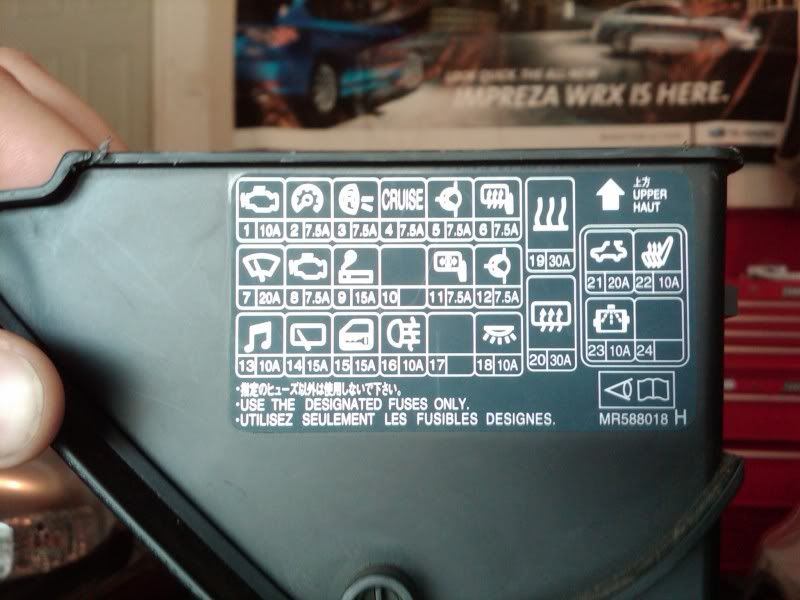

Power for the amp was to the battery, ground was somewhere in the trunk, I’m going to disconnect the amp from the sub and remove that remote wire to the fuse box to see if that does anything. The remote wire was actually wired to the windshield wiper sprayer I believe which is fuse 12 according to this picture I found online
