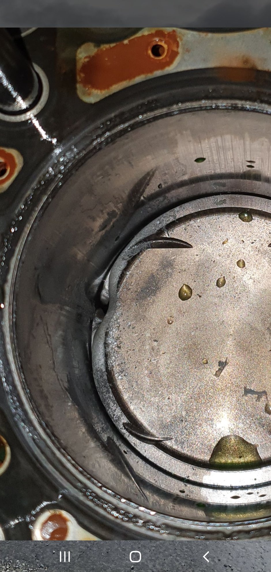

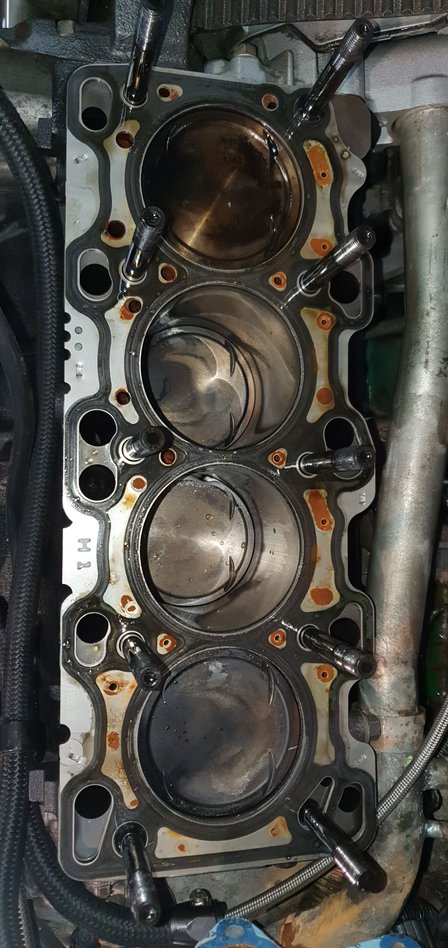

*********Turned out number 3 piston, bore and plug electrode had melted , weird thing is it ran perfectly the whole time even that last race , 6% fuel contaminant in oil , all 4 injectors past test, radium fuel craddle is away getting tested now
, all injector plugs look fine and were attached , no fuel leaks , engine temperature was good the whole time aswell , one thing it sometimes did was die after i had been on boost and come to a stop and was on idle , i would start it and it wouldnt hold its rev , but if i kept the cars revs alive it would find itself again and be fine .. engine isnt running a wideband sensor or any other sensors to do with fuel pressure because i wasnt aware of them during build
Tuner and engine builder dont want much to do with it at all which sucks , it literally did 1000km-1500km on new build without any missing or anything , seriously need any info that may help because i dont want the same thing to happen when it gets build again

hard to know if you had a fuel problem if you have no sensor to read your afr.
with no data... hard to tell...
typically E85 wont detonate, so maybe it was really lean running hot.
or a ringland failure.
too many unknowns to know i would think
