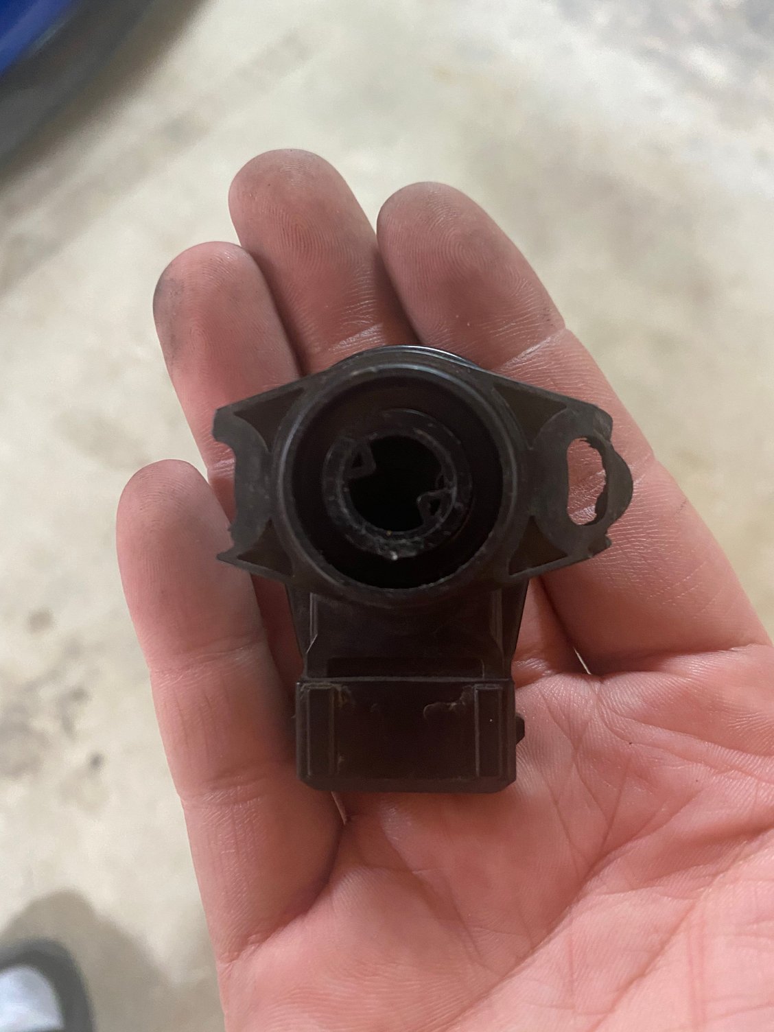

Think I found the issue, I was getting code p0122 for tps. Removed the one in my car and noticed the plastic mounting hole on one side was non existent.
could this be causing the issue, making the tps move a little since it can't properly bolt all the way down?

I'd say, good find!
