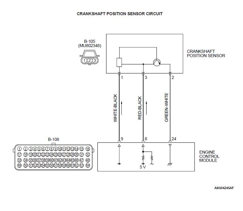

Solved!
The crank sensor was faulty. The signal wire was only sending .03v back when triggered. Replaced it and started first crank.
Notation of symptoms. Fuel Spark and Air were all present but no start condition.

Dealing with a similar issue. What pins did you use to check the voltage for the Cps ?

I checked the voltage from ground to middle pin for the 5v variations when the trigger was passing through it.
