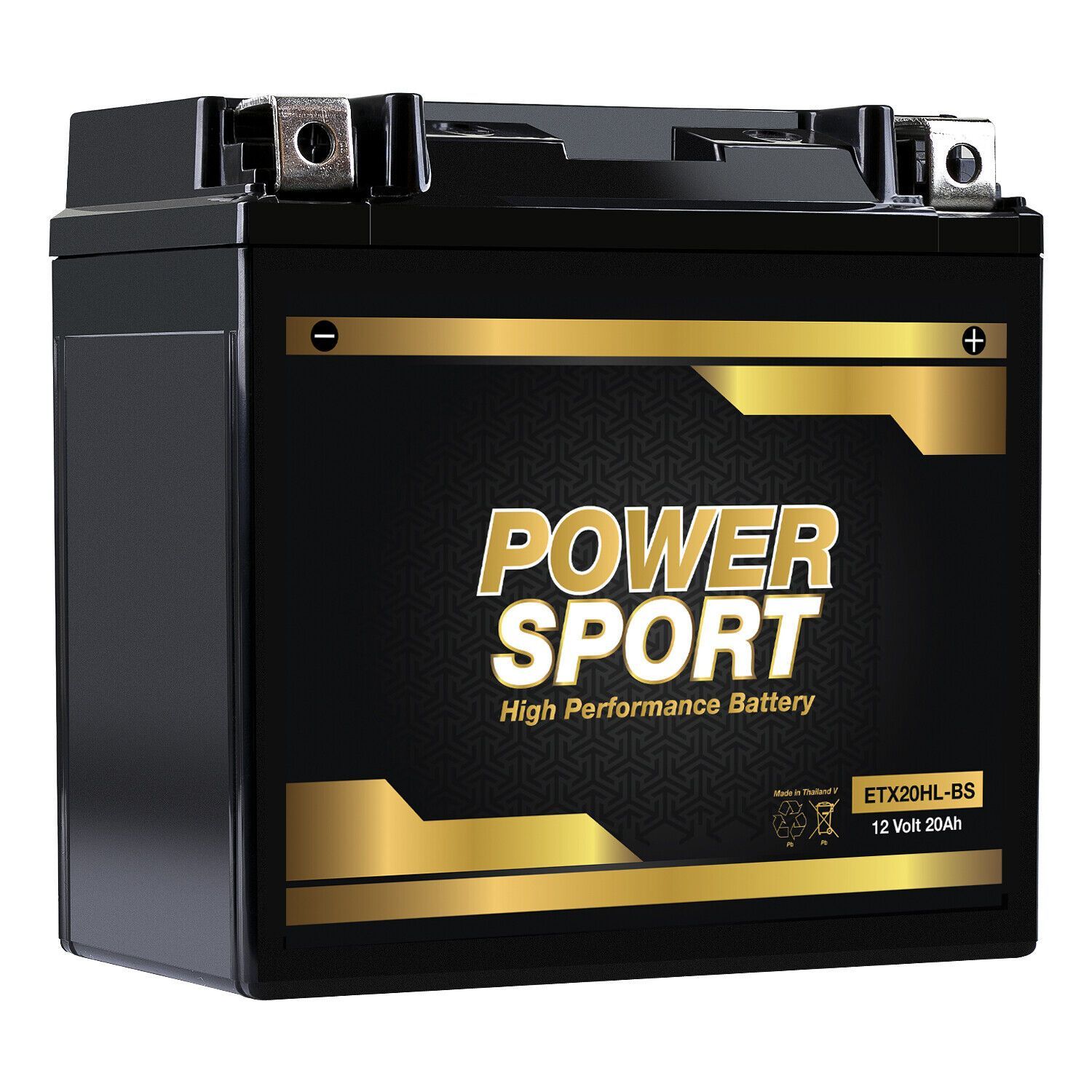

Originally Posted by Kevin.
Those Odyssey batteries are straight garbage.
I think batteries just dont like being shipped. frequent/careless removal/installation of battery terminals cause problems too. But yeah I dont want to pay for a PC680 anymore that has a 50/50 chance of being a good one I just use this now
https://www.ebay.com/itm/143516791683
