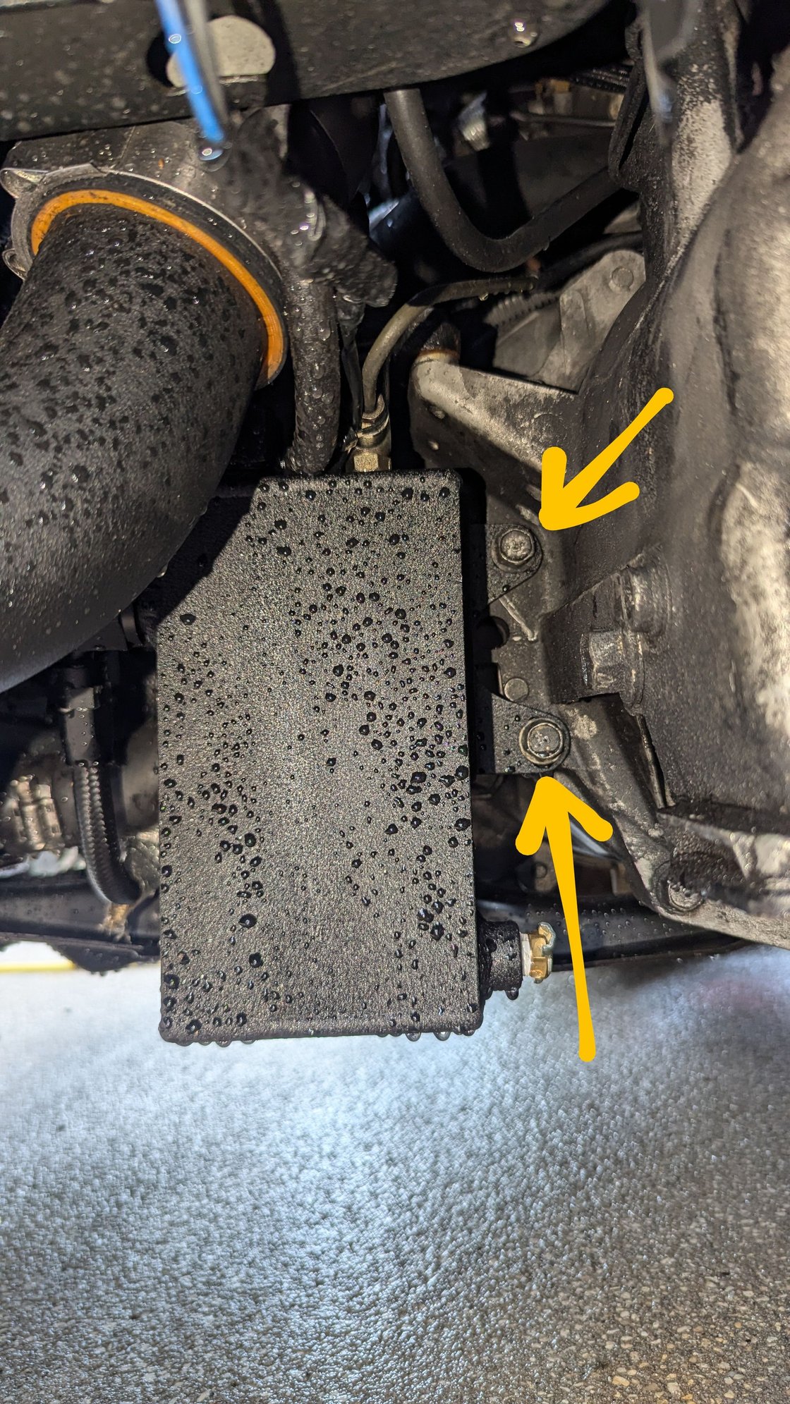

Can anyone tell the me the torque needed for these two bolts? I installed the STM sealed catch can on my Evo 8 transmission but can't find the values. I've looked everywhere and even called STM to no avail. Thank you!!

Transaxle assembly
Bell housing cover attaching bolt (transaxle side) 9.0 ± 1.0 N·m (80 ± 9 in-lb)
Bell housing cover attaching bolt (engine side) 26 ± 5 N·m (19 ± 4 ft-lb)
