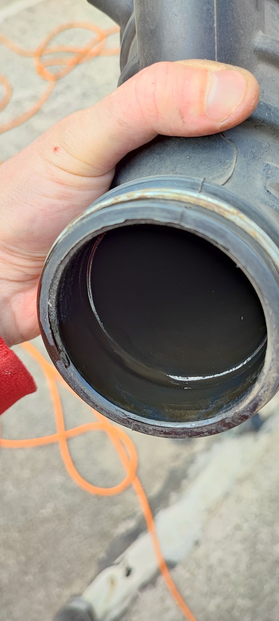

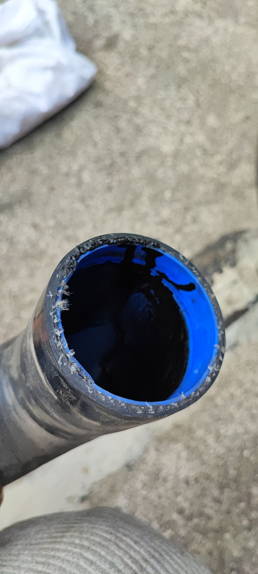

So...found our the turbo Is at the end of his life...there Is oil pretty much everywere in the intake...TB an Intake are covered, don't know if the initial problem Is related to this one, but def i need to fix this first

normally oil in the intake tract is from crankcase air(PCV system), thats where the catch can goes, in between motor and intake hose. best solution is to just stop venting into the intake. turbo leaking into the downpipe can also be caused by high crankcase pressure

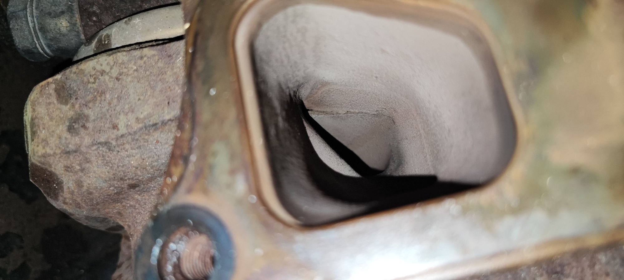

I noticed also this, PCV don't close correctly, when installed don't block incoming pressure...and is on my bucket list, together with a catch can...but the turbo core assey have a lot of play, and more concerning the twin scroll wall cracked...and also 2 lower injector o-rings leak air...also the small actuator on the throttle body (i think for idle) Is full of oil ...so a lot of patience, i will clean and change everything...maybe add some HP during the process. ;

For the removal i just disconnected the feed lines on the turbo, water and oil, Just enough to lower down a little bit so the ex slides off...and, One bolt snapped (strange) 🤣, so was easier to slide out...next step is remove turbo, at first i was thinking about and easy rebuild, but with the twin broken i think i need to replace....IC Is pretty old, and not good looking, so maybe a new one is the best option...but will check when everything Is out...
