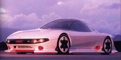

if this means anything it says evo VII's CD is .33 which would make ours .32, but it looks like some dude typed it himself http://tuneman1.tripod.com/mitsu-evo-viii.txt
wow mitsu claims this concept car from 1987 has a CD of .20
Attached Thumbnails Evolution VIII and MR Cd (Coefficient of Drag)-untitled.jpg
