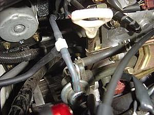

this is where i connect it..
Wrong place. That is after the FPS. Needs to be before.

See the oil dip stick in the pic you posted above? There is a solenoid right behind it in the pic. It is black on a gold bracket bolted to the intake manifold. The vacuum line you tapped into goes to that solenoid. That is the fuel pressure solenoid. On the fuel pressure solenoid, there is another vacuum line going straight to the intake manifold. You can see it in the pic you posted. It is still wrapped in that black coil wrap stuff. That's the vacuum line it should be tapped into.
The link you posted above also tapped into the wrong line.

alright..its fixed thanks your guys!
