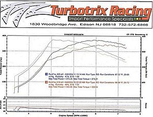

Well I was retuned at Turbo Trix with better fuel. Didn't pick up much on pump(1 Hp and 15 TQ.) Race fuel on the other hand was awesome. Hoping to run high 11's with this setup. We will see Saturday at the shootout.

Looks good Those are some impressive numbers ( especially from the rae gas). How much hp did you pick up with the EMS when it was first tuned at TT? I see you had 342 originally, and then 343, but what octane did you use and what was the difference from before EMS? I am just trying to gauge how much I can expect to pick up from getting the EMS tuned at TT. I would have a BR turboback (w/ test pipe), mbc, intake, and the MAP sensor installed (TT quoted me 340-350 whp with this set up--seems a little high). Also, another concern I have is emissions. How do you deal with emissions? Sorry for the hundred questions- but you seem like just the guy to ask

I would say you will see more like 320. I have cams also and they do make a difference. The first time I dynoed was with bad gas, so we couldn't advance the timing as much. I did pick up an additional 15 lbs./ft. in the torque department today which has to do with timing. Going from the SAFC II, with cams and EMS I picked up 50 hp and 70 lbs./ft. It is awesome you will love it.

Did you dial in your knock control for the AEM EMS? I'm really interested in getting the EMS and have TT to tune it but the only thing that holding me back is I do a lot of trackdays and would like to have the retain/ well tuned the knock control for safty. Congrat on the nice number, car must feel like a rocket? How do you compare the power before and after the AEM? race gase and pump?

Power in both race gas and pump is awesome. It does have knock control hooked up. Mark is very careful with watching knock, he takes no chances. By the way this was all done with a conservative 11.4 air/fuel ratio. It could even be leaned out a bit more it definately has a decent saftey margin.

really nice!
do you know what the actual boost curve looks like with the MBC? how much is it holding at redline?

What do you have for a clutch?
i also dynoed the same amount (5 more hp)my clutch started to slipping.
how much boost are you running?

nice numbers!

I was holding 21 psi at redline, I am running the ACT HDSS setup. It holds very well. I believe I have reached the limits of the stock turbo. The car was tapering boost at redline. Mark told me its because stock turbo cannot keep up with requirements. Bigger turbo in the future.
