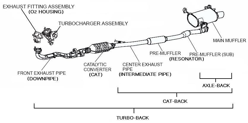

ok as some as you may or may not know, the evo comes stock with 3 mufflers basicaly. my question is has any one other then replaceing the whole exaust or cat back removed one or two of them and just put straight pipe in... at one time i had found a nice post with a great diagram but iv been searching for the past hour and can not find it again...
what blackevovii and I are planning in the near future is to take my stock exaust off and from cat back and removeing one or two of the smaller mufflers and seeing if their is any sound differance when a straight pipe is put in its spot ill try to make sure blackevovii brings his camera so we can hopefully throw up pics of what we are going to do ( did ) when we get to it.
quick question for somone that knows 110% but what is the outside diameter of the stock pipe so i can have the correct pipe i need to put into its place.
I dont know how he did it but blackevovii did it once again with his luck he found the diagram i was lookn for.
https://www.evolutionm.net/forums/at...chmentid=41527

3 mufflers?? Maybe you mean the chambered stock muffler and the stock resonator on the mid pipe. If there are three mufflers, Mitsu forgot to install 2 of them on my car
i went off the diagram i found they all say what on the end of them muffler. ugg. im tired grumy and think it might be a cool way to free up horse power for cheep. ( we will see when i get it done )

I question if this project is going to be worthwhile. Those two resonators are not restrictive. They should flow straight through. Only difference is that the exhaust will have to flow through a baffled region vs. solid walls of your proposed change.
The main muffler seems to be the more restrictive piece. You can do what WORKS does and find a way to keep the flapper valve in the muffler open at all times. Or you can just weld up a muffler delete pipe. Those will probably give you more power gains.
