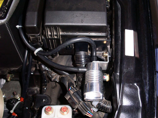

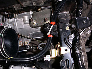

Got it all hooked up. Thanks again for the input. It's kind of a pain in the butt getting to the wastegate nipple. Heres some pics:
Attached Thumbnails mbc install question-mbc-install-2.jpg   mbc install question-mbc-install.jpg
