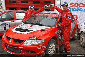

I'm not going to argue the details, so let's just make an observation which can be the third party. Has anyone seen or have pictures that show the configuration of the actual Evo rally car? I have not, but I think there is likelihood that they run without this "glitzy" piece in place. If it truly helps then they will have the louvre piece in use . . .
Can't tell in this picture for sure, but looks like you can see the cam cover in a few thru the opening . . .

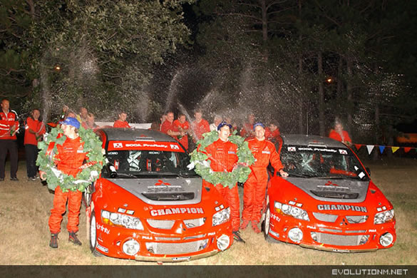

evidence ? you decide
Check out this picture--I see cam covers thru the hoods! But what do these guys care about cooling . . .
Decide for yourself. Don't believe everything you hear--even if it comes from some supposed "tech"
