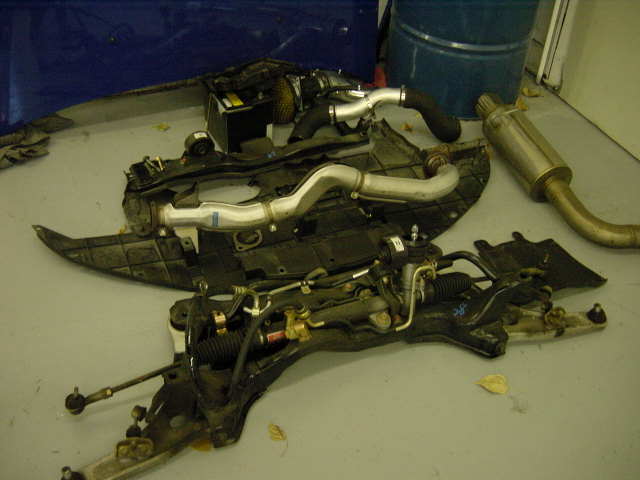

^ that pic is a pretty good one of the underside of the car with everything out.
V this one is of the pile of stuff I had to remove to get everything out. And i gotta say one thing, Mitu sure didnt want that lower cover flying away, there have got to be 20 or so clips in that bad boy.

Pics of the support and rack coming out would be nice...

I can get pics of that next time. And a pic of the steering column disconnent. I did this install for $600. including fluids. (not including the clutch parts) I hear its a fairly cheap price in comparison.
