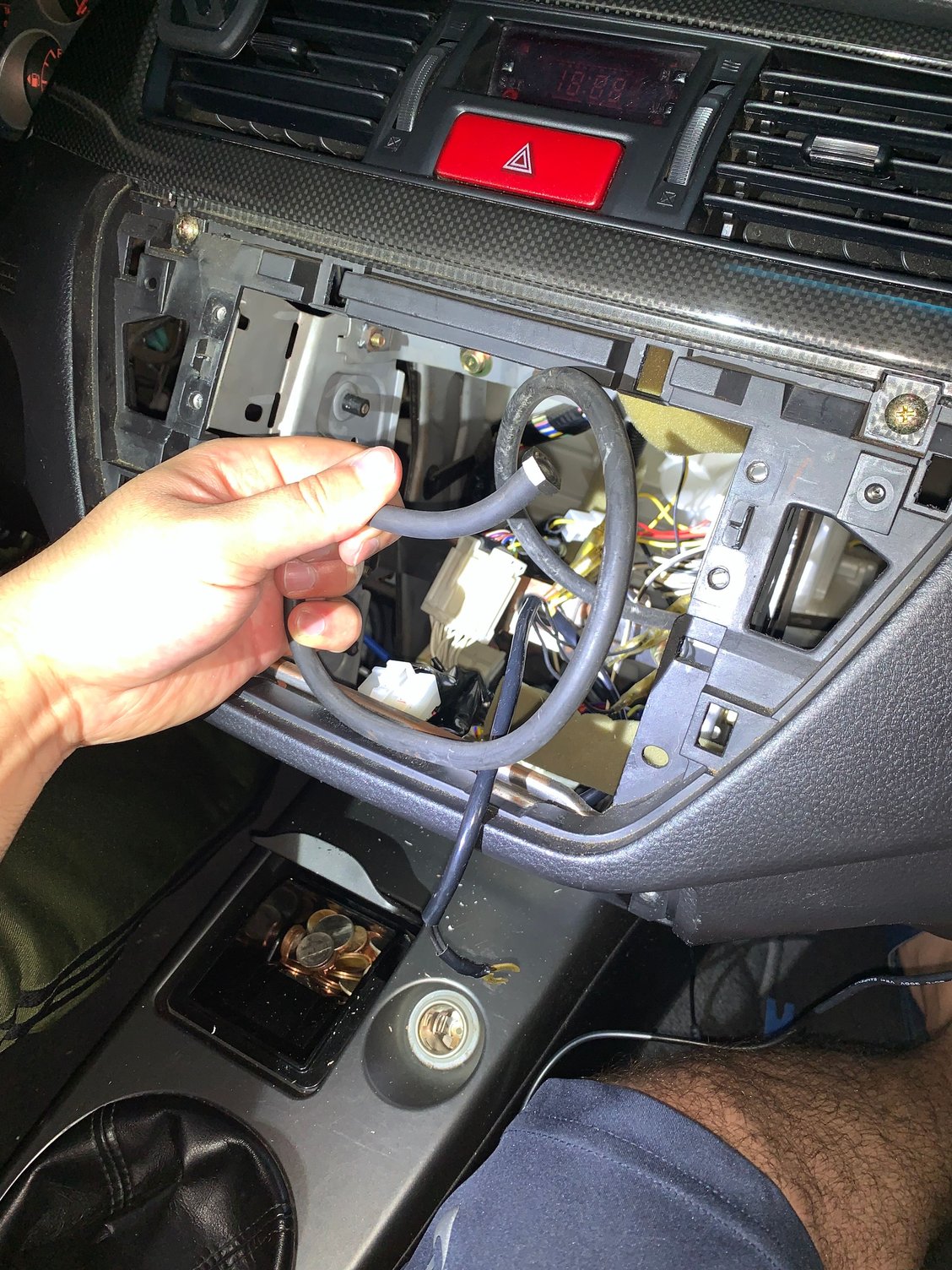

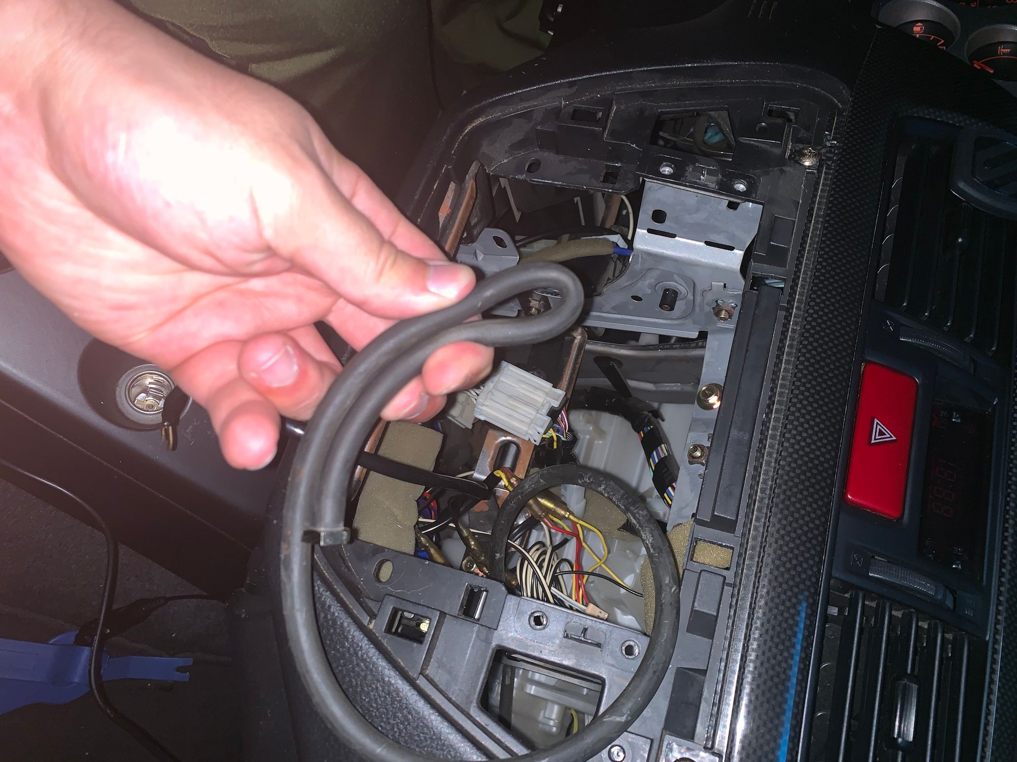

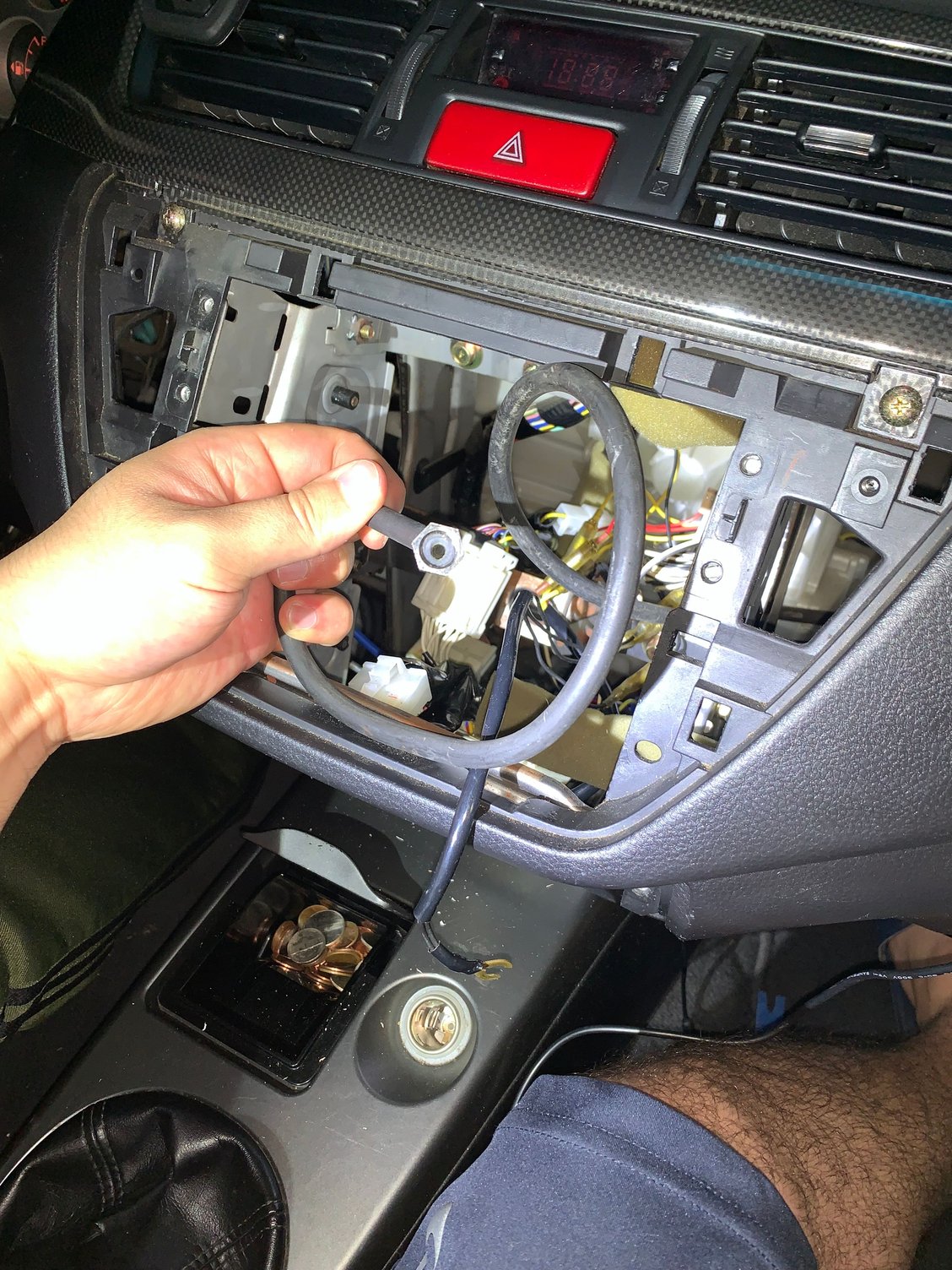

Sorry to bring back this post from the dead but I managed to remove the cluster and hvac so install a double din, when I removed the cluster it had the what I assume is called the "shroud" or hose or whatever, and my question is is it ok to just leave it as is back there with the rest of the wires? Or should I crimp/kinked and just zip tie it so it doesnt leak or whatever it does? As seen on the fourth pic. Any help would be appreciated
