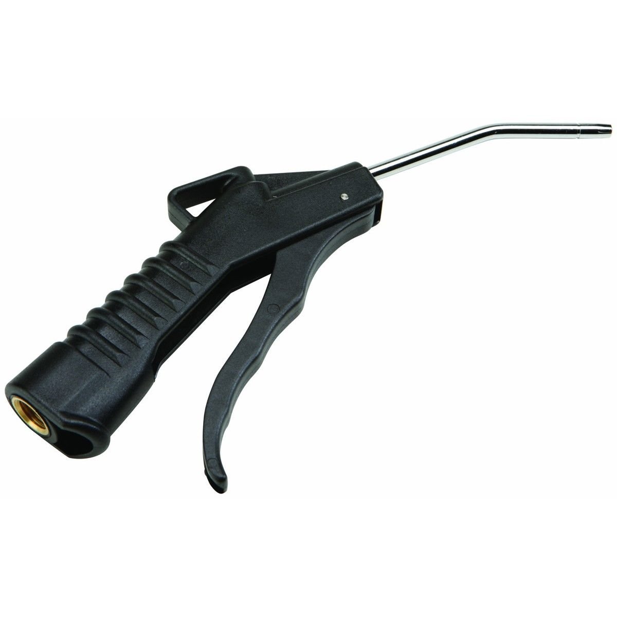

COmpressed air into the wastegate nipple does wonders
This is what I do. I have a Harbor Freight nozzle that fits into the vacuum line, on the wastegate. A quick squeeze of air will move the arm.
If you don't have access to any of that, the I'm not really sure.
