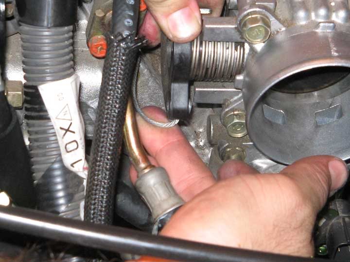

Step 6: Remove the Throttle Cable. Pull the cable away from the guide. Then bring the cable up to the very top part where the pin is. There is a notch where the cable will sit while pushing the pin through the hole, releasing the cable.

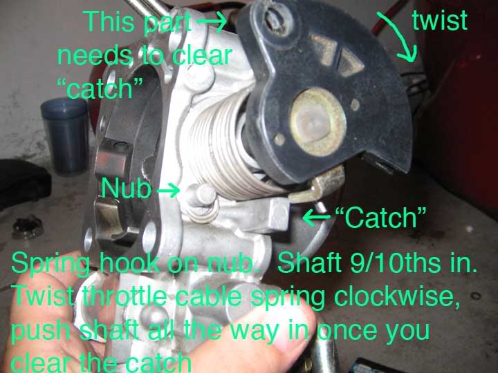

7. Install the shaft back in with the spring attatched. Best bet is to install it about 9-tenths of the way in, then twist the throttle spring so it sets on its catch, then push the rest of the way in. You will need to twist it about a good half turn for it to set on its catch. Make sure the tension is correct.

Check the tension of the throttle cable once everything is bolted back on. If you think the cable has a little too much slack in it before it opens the butterfly valve, you can adjust the "free play" i.e. slack in the throttle cable line by shifting the cable mount to the left.
