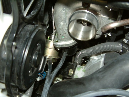

I just bought this 06 evo 9 mr, and i have no idea what the car got in there. Im new to this car, and im still trying to figure out what this car is made and fixed like. i was just wondering if my car has a boost controller or not. can anybody get me some pictures of where my turbo boost controller could be located at?

http://www.addictiveperformance.com/...rorx_large.jpg
ill put a picture of that because the hallman is used in alot of evos.
thats is a basis of a it will look like it will have 2 seperate hoses going to both the side and bottom nipples. also you can check to see if there is a line teed into the bov line. thats a picture of a bov line teed into
http://i6.photobucket.com/albums/y21...82434_2654.jpg
and the other way you can check is see if the turbo and wastegate nipple and follow those lines and if there is a mbc those lines will lead you too it. heres a picture of both the turbo and wastegate outlets.
https://www.evolutionm.net/forums/at...n-dscf0080.jpg
you can find these outlets if you look under your intake pipe.
