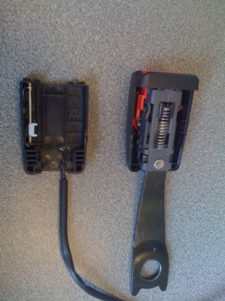

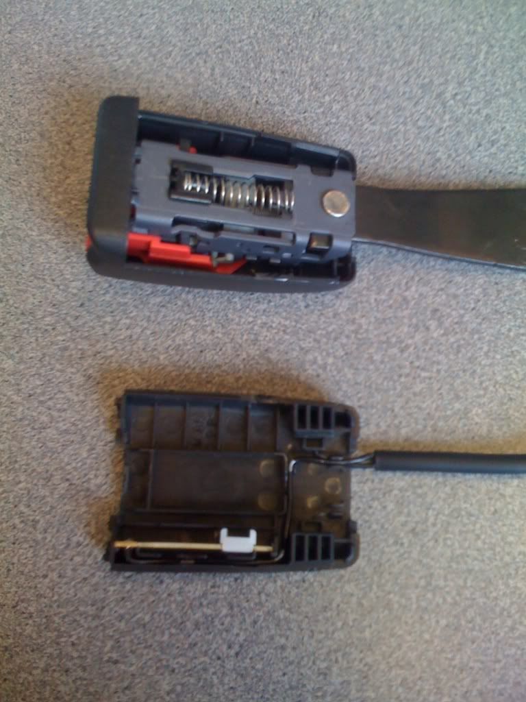

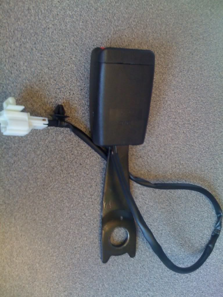

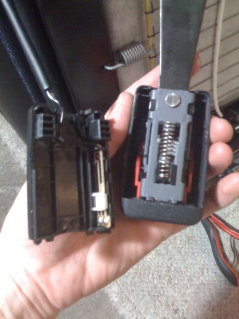

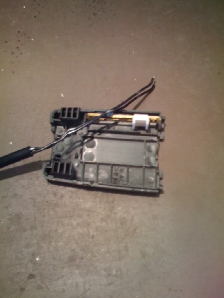

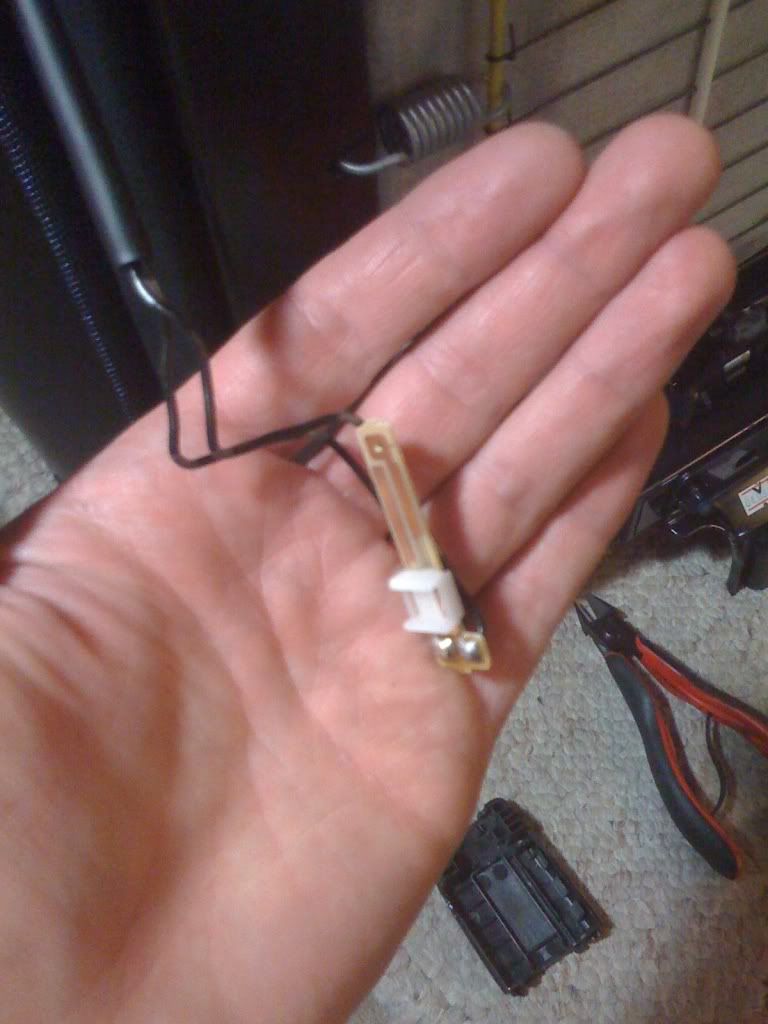

I did get it done and done very cleanly. The trick is to pop the plastic receiver body open and remove the little circuit board inside. Then unsolder the two wires. Once this is done the entire wire assembly can be pulled through the side of the seat. Then it's a simple matter of resoldering the wires and clipping the plastic body back together. I'm likely to be the only person with the factory 3 point belts still installed (and useable) with racing seats. I even reconnected the white clip under the seat so my seat belt light on the dash works (not like it needs to). Pics included.
