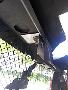

I decided to make a pair of aluminum brackets but you can easily use anything similar from the hardware store. The screws mount to the OEM holes that connect to the metal bumper brace and simply replaced the plastic inserts.
I extended each positive line to the respective horns on each side and for the negative, I picked up from the screw of the OEM horn in the middle and ran it first to one horn then to the other.

and there is plenty of clearance with the AC fan and the larger intercooler. you can mount them closer to the center or space them wider apart. its easily adjustable. I will replace the two visible screws but I just used something I had for now..

you have to get to the original horn wiring anyway so the bumper has to come off. honestly this was the 2nd time removing my front bumper and the screw in the wheel are came off very easily. without the bottom plastic engine tray, the bumper came off in 2 minutes.
