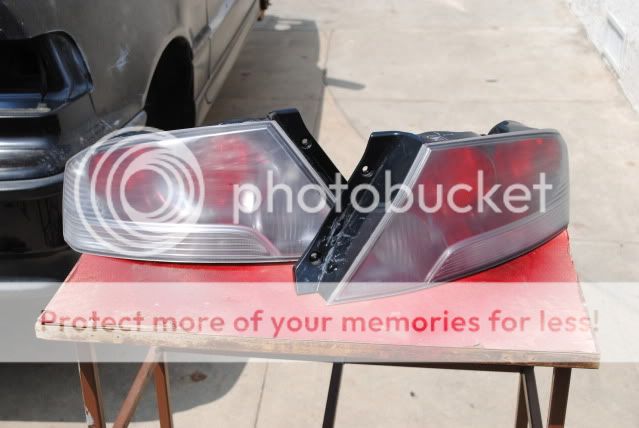

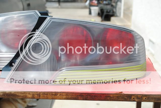

alright guys so i missed my VII replica tails so i had to replicate them again and here are the steps and the turn out. I also do this as a little side job pm me if you guys want yours done also
ATTENTION : I AM NOT RESPONSIBLE IF YOU TRY THIS AT HOME AND RUIN YOUR TAILS THIS IS JUST A DO IT YOUR SELF AT YOUR OWN RISK.. I AM NOT LIABLE FOR ANY DAMAGES DONE TO YOUR CAR OR DAMAGES.

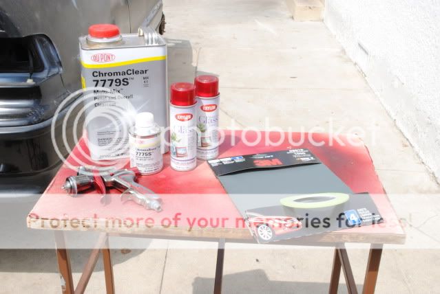

Intro and materials

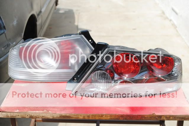

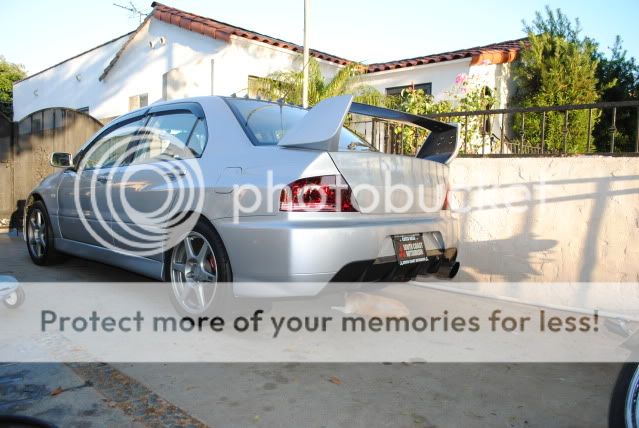

before pic

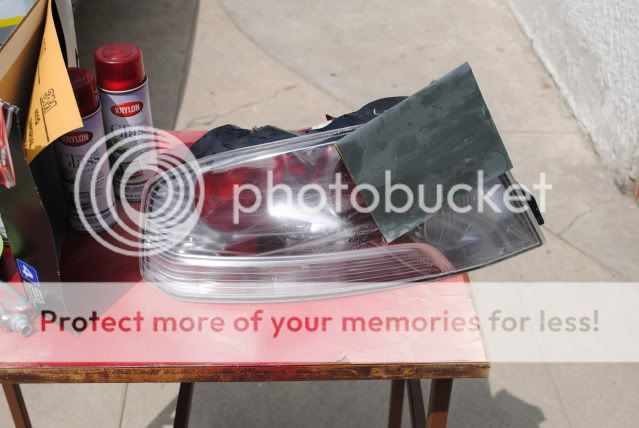

step 1: wet sand with a 1000 grit sand paper
how its suppose to look after wet sand
both tails wet sanded

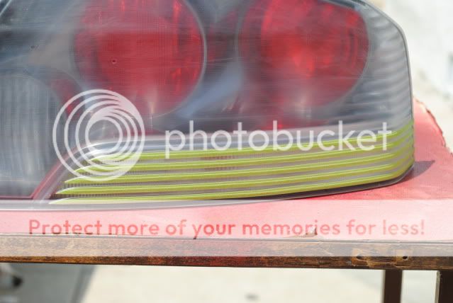

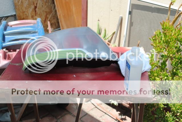

Step2: after wet sanding you need to tape the lights in the bottom portion to replicate the VII tails

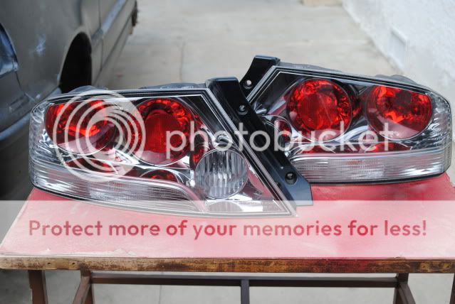

step 3: with rubbing alcohol rub them down to remove any grease and dust

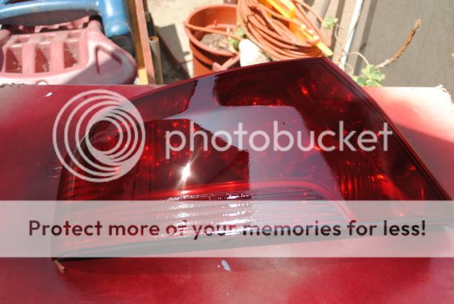

step 4: shoot the paint in a non windy shaded area this paint dries quick and will crate a hazy look (trust me i have to re do my first set 2 x not fun)
step 5: sorry guys no pic but details: after letting the tails sit for about 15 min remove the tape and shoot clear 3 coats first coat is a mist to become a adhesive, 5 min later second coat wet with out running the clear so it gets the shine, 3rd coast the last mist so it protects the shine>.

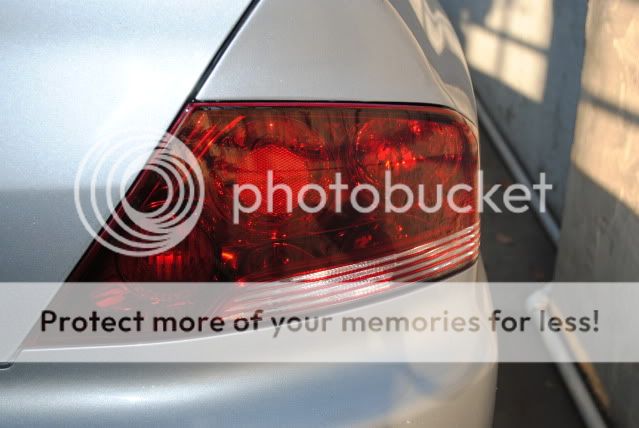

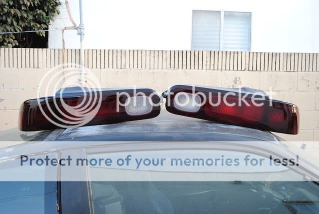

step 5: installing the finished product

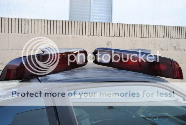

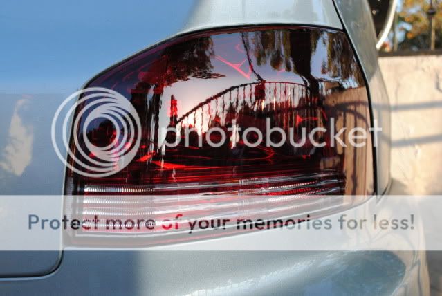

extra pics for you honda guys :P 94 integra lights converted to 99-01 all red tails
before
after

They aren't the right shade for a perfect match, but you did a great job with attention to detail and quality.
Old Aug 23, 2011 | 10:39 PM
got_evo8's Avatar
Joined: Feb 2011
Posts: 13
From: long beach
yeah they're darker but i did them like that for the reason the real jdm 7 lights look pink to me but. i love the darker shade of red

Originally Posted by DRCperformance
How many coats of red did you use?
Clean job, regardless if it matches or not.
Thanks , I used 3 coats first coat was a light mist just to get it to be a adhesive for the second coat, second coat was the wet coat was a slow left to right 75% over lap at this point they will look exactly like te red tint on the O.G evo VII lights and the third coat is a mist coat to get it a bit darker
