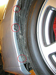

Under each wheel well, remove 1 bolt and 2 philip head clips.

I used a philip head drill bit to unscrew the clip. You may have to apply no pressure in order for the threads to catch.
