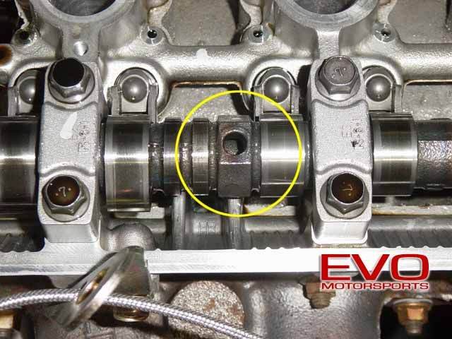

To answer your question, the car in gear doesn't matter too much because there will be some movement in the motor regardless. You will want to put a wrench around the cam shaft in the "hexed" location and break the 17mm bolt loose with a breaker bar. The timing tool will go in after you have zip tied the timing belt to the cam gears.
Picture taken from evomoto:
