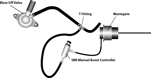

So Al you suggest hooking the Hallman up like this then?
Attached Thumbnails Hallman boost controller in stock SALE!-boost_controller_diagram.gif

Posts: 2,817
because this is how I have my mbc installed, with mbc running to the wastegate, the nipple from the turbo capped off and the other nipple of the mbc t'ed off in between the line for the bov to the valve cover.
Attached Thumbnails Hallman boost controller in stock SALE!-boost_controller_hookup.gif
