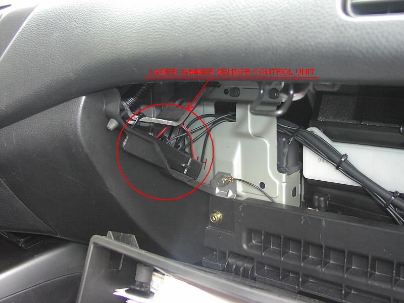

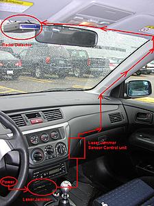

Sorry, I had the company car last night. I'll have my car tomorrow, I'll snap some pics during lunch.
Old May 19, 2005 | 08:40 AM
MIevo8MR's Avatar
Posts: 231
From: Southeast MI
Pics!!!
Hope these pics help. Let me know if you have any other questions.
Attached Thumbnails Need Help with Wiring-radar-detector.jpg   Need Help with Wiring-laser-jammer.jpg   Need Help with Wiring-sensor-control-unit.jpg   Need Help with Wiring-power-tap.jpg   Need Help with Wiring-routing.jpg
